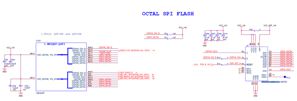

q325mg
Hello Igor,
Thanks for your answer
I'm confused because in the SPF-29683-C2.pdf schematics (MCIMX8QXP-CPU MEK Platform)
There is this diagram:
Also in the i.MX 8QuadXPlus MEK Board Hardware User's Guide (IMX8QXPMEKHUG) there is this:
Where can I fond more information about FSPI on i.MX 8QuadXPlus MEK?
3,606 Views
igorpadykov
Hi Isaias
one can look on Figure 1. i.MX 8QuadXPlus/8DualXPlus System Block Diagram,
Table 4. i.MX 8QuadXPlus/8DualXPlus modules list, Table 91. FlexSPI timings
i.MX 8DualX Automotive and Infotainment Applications Processors
and i.MX 8DualXPlus/8QuadXPlus Applications Processor Reference Manual
igor
