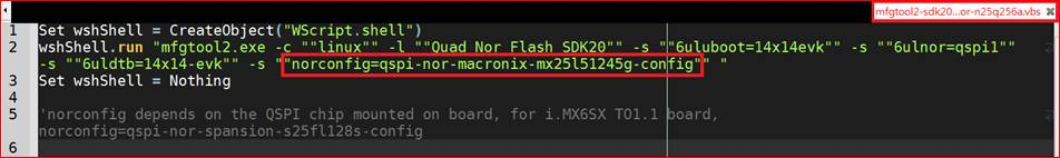

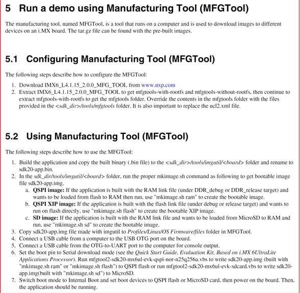

Now, I am following "Getting Started with MCUXpresso SDK for i.MX 6ULL Derivatives.pdf" to programming source code on GD flash.
Chapter Five: Run a demo using Manufacturing Tool (MFGTool)

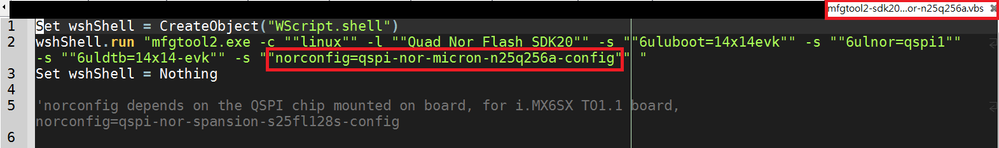

1. I trying to modify "mfgtool2-sdk20-mx6ul-evk-qspi-nor-n25q256a.vbs" file from
to
and than call "mfgtool2-sdk20-mx6ul-evk-qspi-nor-n25q256a.vbs" to programming source code on the GD flash.
But doesn't work.
