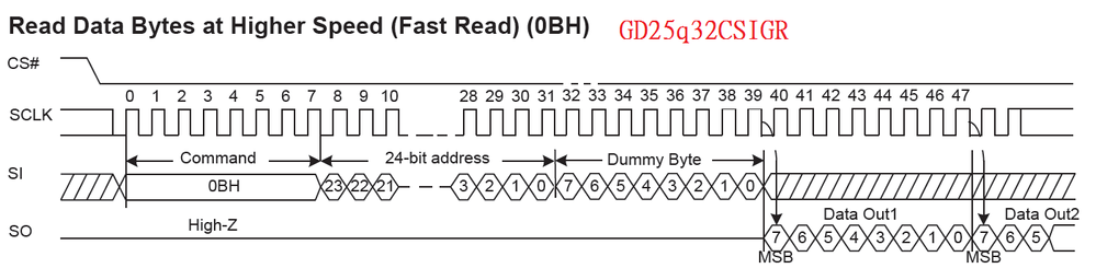

Now I trying to use LUT program sequence of macronix-mx25l51245g to boot up GD flash (GD25q32CSIGR)
Because of the GD25q32CSIGR sequence is same with macronix-mx25l51245g
Please refer as follows:
But still doesn't work
Could you help me solve this problem?

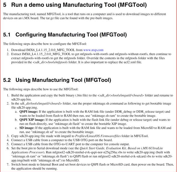

Now, I am following "Getting Started with MCUXpresso SDK for i.MX 6ULL Derivatives.pdf" to programming source code on GD flash.
Chapter Five: Run a demo using Manufacturing Tool (MFGTool)

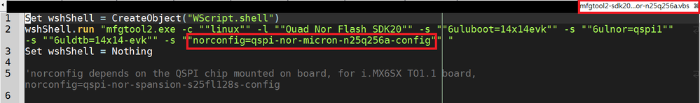

1. I trying to modify "mfgtool2-sdk20-mx6ul-evk-qspi-nor-n25q256a.vbs" file from
to
and than call "mfgtool2-sdk20-mx6ul-evk-qspi-nor-n25q256a.vbs" to programming source code on the GD flash.
But doesn't work.

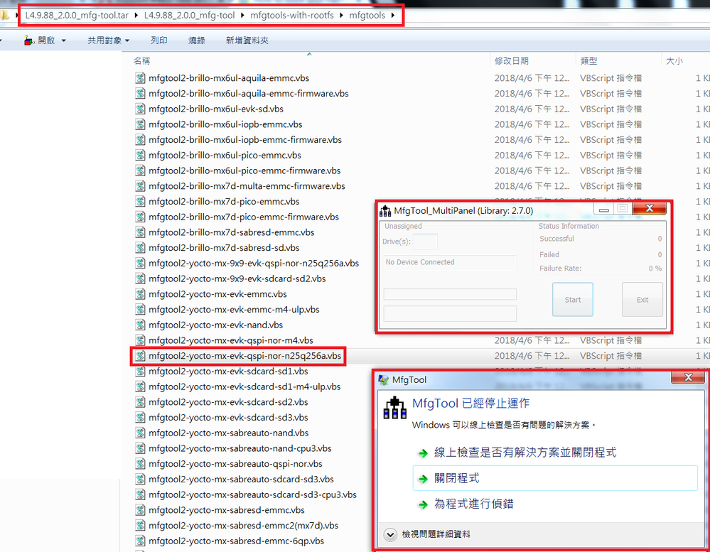

3. I am trying to use your suggestion, download "L4.9.88_2.0.0_mfg-tool" form NXP
and I am calling "mfgtool2-yocto-mx-evk-qspi-nor-n25q256a.vbs
but the MFGTool destruction when system power on
Can you description step by step, thanks.
