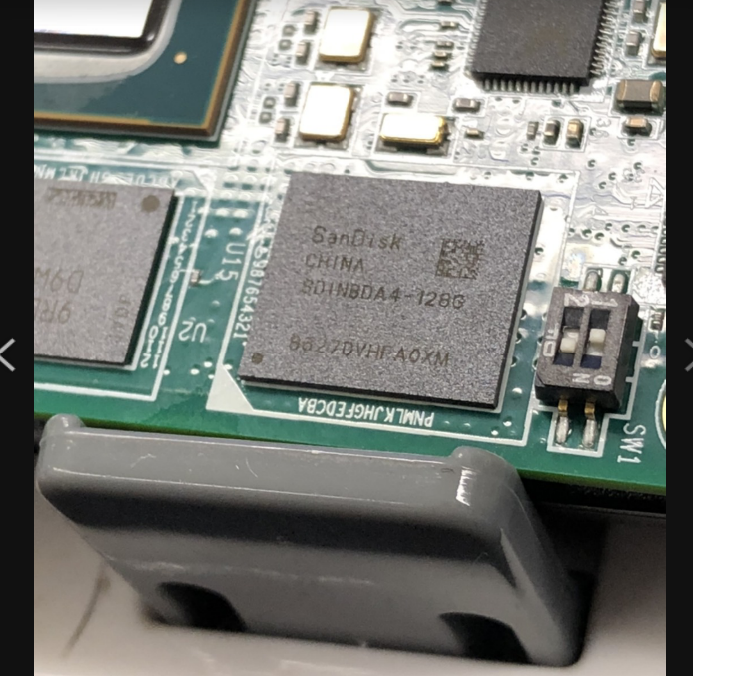

Hi Sir,
My customer want to expand EMMC size from 32GB to 128GB. We modify and new a 128GB bpt file as below.
1.
"settings": {
"disk_size": "128 GiB",
"disk_alignment": 2097152,
"first_partition_offset": 8388608
2. Modify ~/ANDROID_CODEBASE/device/fsl/imx8m/rom5720_a1/BoardConfig.mk
# Support gpt
BOARD_BPT_INPUT_FILES += device/fsl/common/partition/device-partitions-13GB-ab.bpt
ADDITION_BPT_PARTITION = partition-table-7GB:device/fsl/common/partition/device-partitions-7GB-ab.bpt \
partition-table-128GB:device/fsl/common/partition/device-partitions-128GB-ab.bpt \
partition-table-28GB:device/fsl/common/partition/device-partitions-28GB-ab.bpt
We try to use uuu tool and get a fail when use download command.
./uuu_imx_android_flash.sh -f imx8mq -a -e -c 128
Please help to modify a "128GB dual-bootloader" .bpt file for 128G eMMC.
Thansk~

Rita_Wang
Could you share us your 128G emmc part num or picture to us? Many thanks.
Have a nice day

Rita_Wang
The configuration method is the same. It seems that your emmc is 64GB. Could you confirm again about customer's emmc? If it is 128GB or 64GB?
Have a nice day
Best Regards
Rita
14,317 Views
weikeng-jimmy
Hi Sir,
It's 128GB.
14,272 Views
Rita_Wang
I have saw you picture and discuss with our team members, maybe you can try another one emmc, not this one, If you have on your side.
14,219 Views

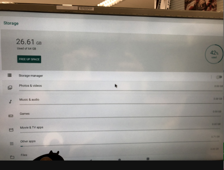

weikeng-jimmy
We want to change Emmc size to 128GB not 28GB .So We use 128GB .bpt file to generate 128GB .img file You means can use partition-table.img to burn 128GB Emmc ?
14,470 Views
Rita_Wang
Yes, the 32G or above you can use it.
14,455 Views
weikeng-jimmy
The test result is still show 32GB not 128GB as below post . Please help to check it. Thanks~
14,478 Views
Rita_Wang
Here you do not need to modify the bpt file, you can ask customer to rename partition-table.img to partitiontable-
28GB.img in the corresponding UUU script.
