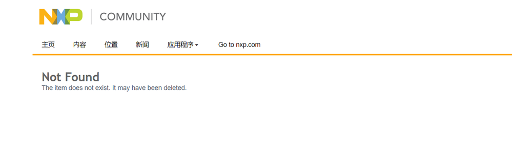

    The chip I used is imx6sx, and the BSP version is 4.14.98,and the LCD drive mode is rgb565.Now I can display the logo in Uboot and kernel respectively, but during kernel startup, there will be a black screen around 3S, displaying the Linux logo.
    I have referred to this issue:
Patch to support uboot logo keep from uboot to kernel for NXP Linux and Android BSP (HDMI, LCD and L... Qiang Li - Mpu Se
    but the attachment cannot be downloaded, which indicates the error in the following figure:
Labels (4)
