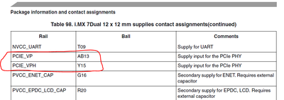

I use i.MX7 which is MCIMX7D3EVK10SD (12 x 12 mm) and I would like to use the Boundary scan test.
According to document "IMX7DSHDG" that mentioned as following.
So, My hardware design will supply to PCI PHY, but MCIMX7D3EVK10SD has no PCIE_VPTX pin.
(MCIMX7D5EVM10SD(19 x 19 mm) has PCIE_VP pin , PCIE_VPH pin and PCIE_VPTX pin.)
Should I design to power supply to  only PCIE_VP pin and PCIE_VPH pin?

yes, correct, you can compare the difference between them
19x19
12x12

what do you mean MCIMX7D3EVK10SD has no PCIE_VPTX pin? do you mind sharing your connection about PCIE_VP pin and PCIE_VPH pin?

According to Data sheet IMX7DCEC.pdf, in table 99 "iMX7Dual 12x12mm supplies contact...",  there are PCIE_VP (AB13 Ball) and PCIE_VPH (Y15 Ball), but no PCIE_VP_TX.
On the other hand, table101 "iMX7Dual 19x19mm supplies contact...", There is PCIE_VP_TX (AA11 pins).
I use 12 x 12mm package. So that, I can not connect supply power to PCIE_VP_TX ball.
19x19
12x12

As per your reply, I  intend to power supply to PCIE_VP and PCIE_VPH for using Boundary Scan.
I don't use PCIe function, in that case, should other PCIe signals  (ex. PCIE_REXT)  are connected to floating or tie to grand?
Should I follow the "Table 5 Recommended connections for unused analog interfaces"  in "IMX7DCEC.pdf" excluding PCIE_VP and PCIE_VPH?
like below fig.?

yes, if you don't use it, you can refer to the design guide
