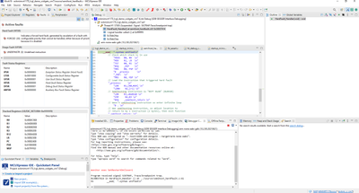

I am trying to modify the SDK example to use one SDRAM instead of two available on board.
I modified the memory settings and the DCD file. I tried multiple configurations but I always end up with a fault.
How can I run a lVGL example using one SDRAM?

All SDKs work on our custom boards with exceptions to MIPI and LVGL Examples. This is likely because our board has only one SDRAM. By changing some configurations, we get a Hardfault or the program will simply not run/flash or halt on the first instruction. We tried serial, QSPI Flash and Mcubootutility.

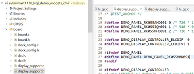

Just for double check, are you connecting the LCD display before running the LVGL and MIPI examples? Could you please check if the LCD display that you are using is the one you choose in board -> display_support.h?
[MCUXpresso IDE v11.7 -> lvgl_demo_widgets_cm7 -> board -> display_support.h]

We are using the default Rocktech screen. We also used another screen with our display driver files that we know it work, but the issue is that we are unable to flash because of the hardfault. We tried all the configurations mentioned in the previous post. We used different Mcuxpresso versions and different LVGL/MIPI examples. We used OZONE by Segger and we got the same hardfualt.
What can produce this type of error? can it be a hardware issue that is specific to lvgl or examples that uses SDRAM. Did we need to change something else in memory settings?
I also want to mention that we use JLINK Plus for debugg.

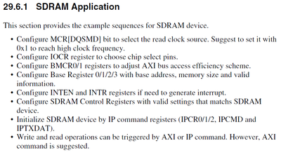

About what can produce the error? It could be related with the SDRAM configuration (hardware or software) for LVGL not to work as expected.
Looking at the IMXRT1170 Reference Manual, there are steps related with the SDRAM that might be good to check with your code:
[IMXRT1170RM Chapter 29. Smart External Memory Controller (SEMC)]
Have you done any software changes to use your SDRAM or have you run the examples exactly as they are? If you made changes, what did you change?
