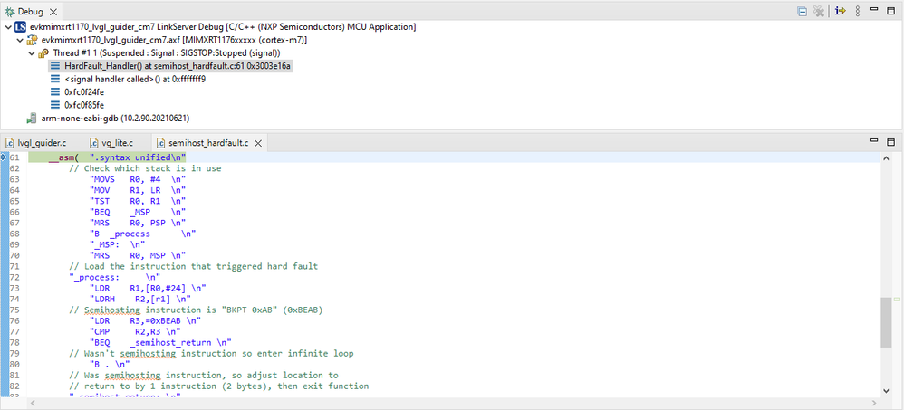

I'm using a custom board designed after the NXP 1170EVK board, the main differences are we removed unused peripherals (ethernet, camera, etc...), it doesn't have the M4 core, and it only has 1 external SDRAM chip instead of 2 (same chip is used though Winbond W9825G6KH-5I). The board works great when only using the QSPI Flash and the internal memory. I've been able to get several examples from the SDK to work with the board with little to no modification. What I haven't been able to do is get any of the demos that use the SDRAM as the primary RAM, I'm unsure what configuration (if any) so that the board knows there's only 1 SDRAM chip instead of 2. I've taken screenshots to show some of my successes and issues below.
Successfully executing the usb_msd_fatfs_freertos_cm7 demo, our main program will be running FreeRTOS and be using the USB to save log files:
SDRAM is circled in red to show that it successfully runs because nothing is put into it.

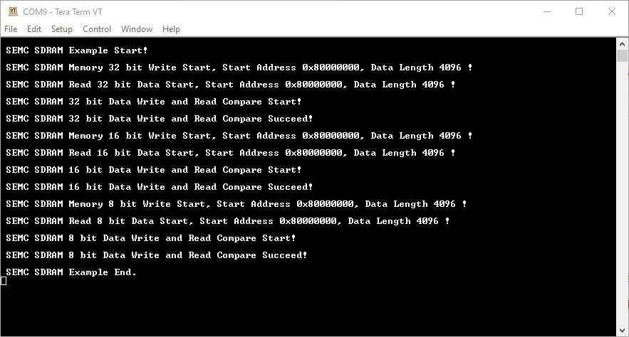

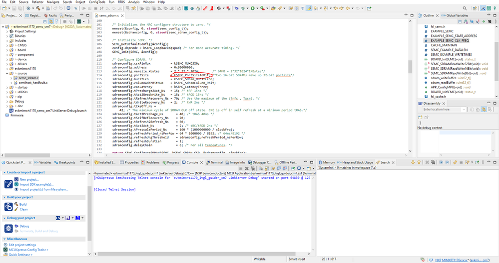

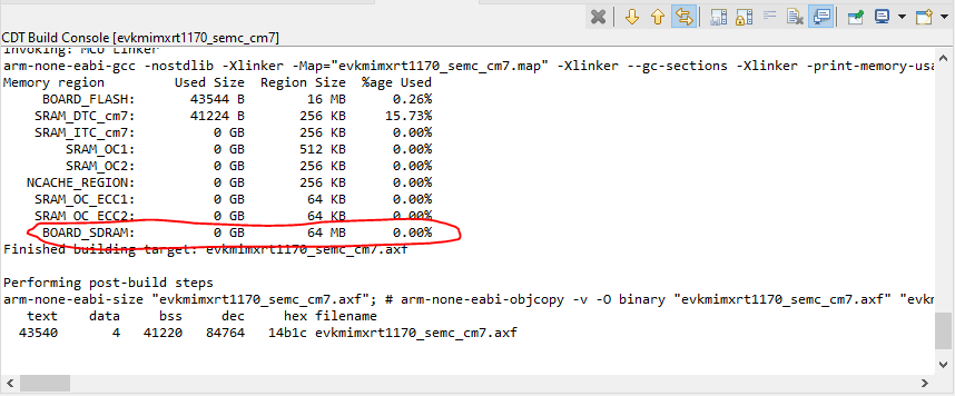

The semc_cm7 demo also surprisingly runs when modifying one line of code:
Once again, circled in red you can see the one line that needed to be edited to read and write to the SDRAM, but also circled in red no program data is in SDRAM, all internal.
Finally I try to get the lvgl_guider_cm7 demo to work, it requires having an external RAM as primary due to the size of the library and the screen buffers, it cannot fit internally.
Now that SDRAM is set as the primary RAM, the debugger gets a hard fault before reaching main(), I'm unsure of where to go, I've scoured forums looking for answers but haven't found anything fruitful. I'm curious if anyone know what configurations need to be set, either in the code or in the MCU settings for this lvgl demo to work with my setup.

Thank you for the reply, I've got the information you've requested. I just double checked and yes the evkmimxrt1170_semc_cm7 demo will run (and get succeed messages) after only changing the sdramconfig.portSize to 16-bit instead of the default 32-bit, no other changes were made. If it matters this SDK demo came from the SDK_2.x_MIMXRT1172xxxxx SDK version 2.12.1. Secondly I've taken some screenshots of the schematics involving the SEMC unit (including our NAND flash).

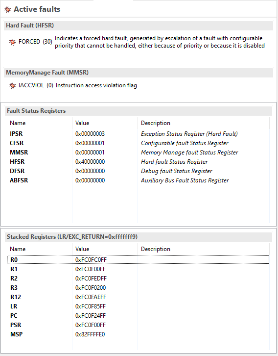

The hard fault occurs in this function. Also all the Registers being 0x00000000 seems off.
We can see that it is clearing memory for lvgl and calls on lvgl's custom memset function (posted below).
Now this function says it's optimized for 4 byte operation, maybe that has something to do with it? Since our SDRAM is only 2 bytes wide for it's data. I'll look into this and report back if I can get anything to work, otherwise I'll await your reply.

I've made some progress on getting it to work, but ran into more errors/faults. After a bunch more research I looked into modifying the DCD file using the DCD configuration tool (never done this before), I was able to find the register that has SDRAM setup as a 32-bit port, and changed it to 16-bit (like in the SEMC demo). This allowed me to get passed the first hard fault. Now what happens is sometimes it hard faults from either invalid state, bus fault error, usage error. On the other hand, sometimes it makes it to the main(), when it makes it to main it crashes in the BOARD_ConfigMPU() in the part where it tries to setup the non-cacheable region. I'm unsure if there are more changes required for this demo to execute properly on my board.

I just tested the demo you attached and unfortunately I'm still receiving hard faults. Sometimes it reaches main() and will get a usage fault in the BOARD_ConfigMPU() at this particular line:
/* The MPU region size should be 2^N, 5<=N<=32, region base should be multiples of size. */
assert(!(nonCacheStart % size));
Sometimes it won't make it to the main() and hard fault in the SystemInitHook(), either return invalid state or undefined instruction. Other times it hard faults and can't trace back to what triggered it and returns Bus Fault Address Register (BFAR) along with IMPRECISERR and PRECISERR at the same time.
