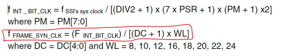

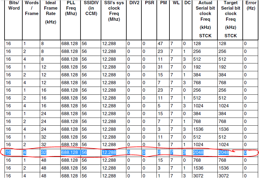

We are modifying the SSI2_SRCCR register with the below mentioned red marked values, Here we are getting 32 Khz of Frame Sync signal which is correct as per thebelow table. But can it be possible some how to get the 2.048Mhz of STCK with  8KHz of Frame Sync?
I tired to calculate the Frame sync frequency with this formula by putting WL = 7(16), DC= 15 , DIV2=0, PSR=0 and PM=2 with 2.048Mhz of STCK, but, Did not get any success.
Could you please suggest any solution on this?
