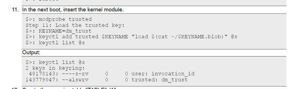

We're checking the an12714 (attached), they're using dmsetup instead, however still having a reboot in the middle and using the same black key generated from the blob in different boots to decrypt the partition. What am I missing here?

It is very clear description in 2.3 DM-Crypt using CAAM's Secure Key of AN12714.
The black key is session key.
The DM-Crypt  is using red key to do encryption not the black key.
The black key changing every power cycle. But CAAM will get the same red key.
If you read i.MX Linux User's Guide(bsp release document) 10.6 crypto_af_alg application support or crypto af_alg blackkey demo - NXP Community.  , you can see  it doesn't matter the black key is changing. CAAM knows the openssl key to decrypt the encrypted data.
black key is used to protect red/plaint text key.  black key is not directly used for encryption.
suggest you can read  i.MX Linux User's Guide(bsp release document) the  10.5 Disk encryption acceleration.
