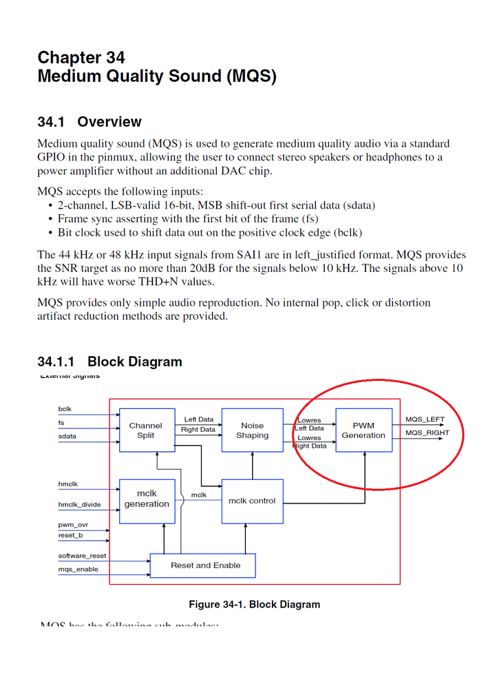

BiyongSUN
maybe you can check the Medium Quality Sound (MQS) of i.MX6UL to see if meet your requirements.
