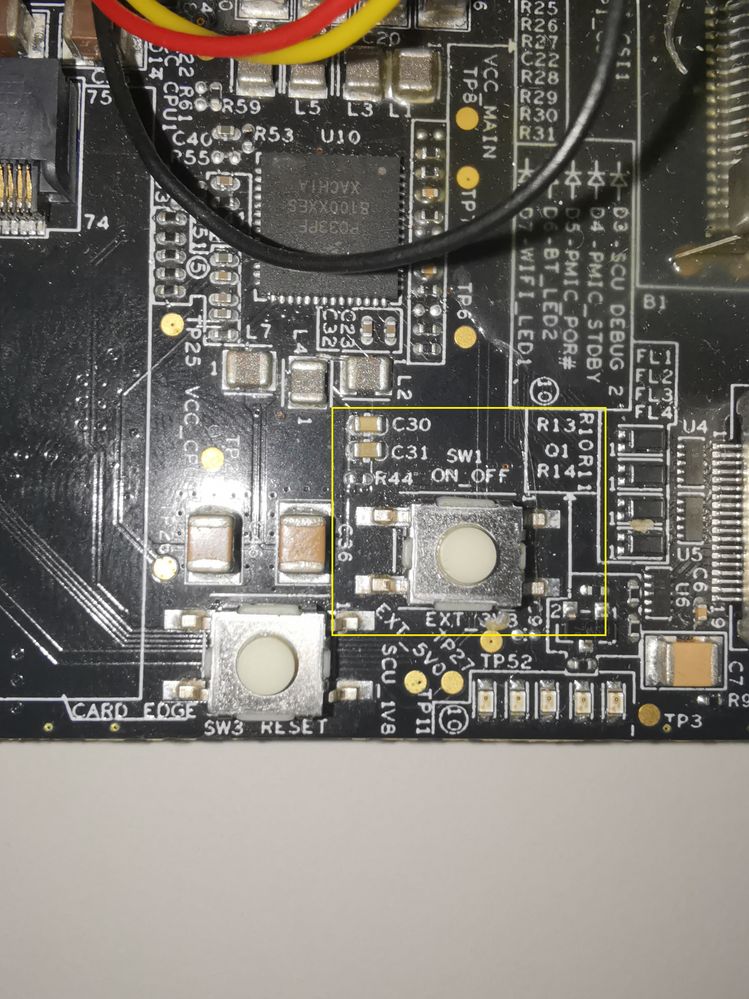

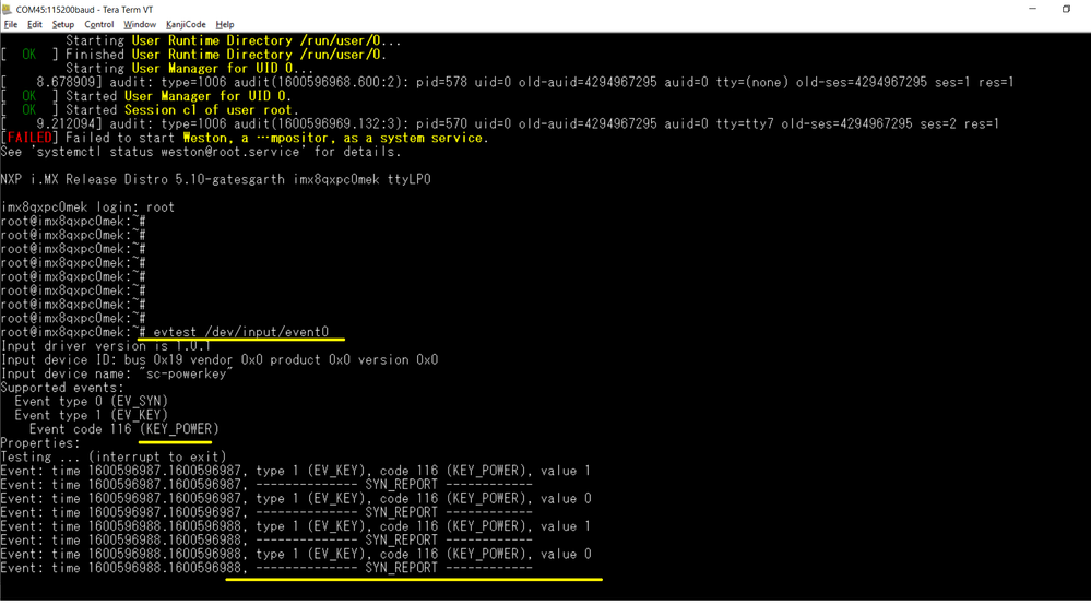

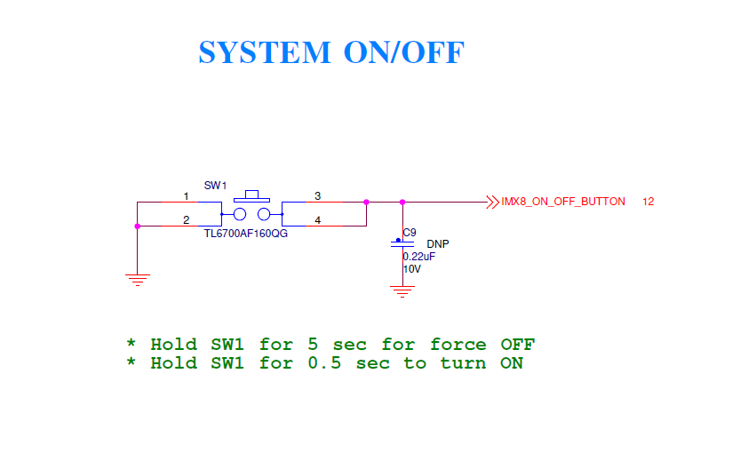

the chip has this feature and BSP has already implement the sc_pwrkey(compatible = "fsl,imx8-pwrkey";
short press as wakeup source and long press power off and power on(working with PMIC).
for you case, you may need as hardware invert signal.

BiyongSUN
As previous reply, the hardware and BSP already have that function.
sc_pwrkey(compatible = "fsl,imx8-pwrkey") in dts;
12,024件の閲覧回数
BiyongSUN
If you don't want the snvs on off button as power off button, you can use gpio-key add one key for that.
It is the same thing, just use that gpio to send KEY_POWER event.

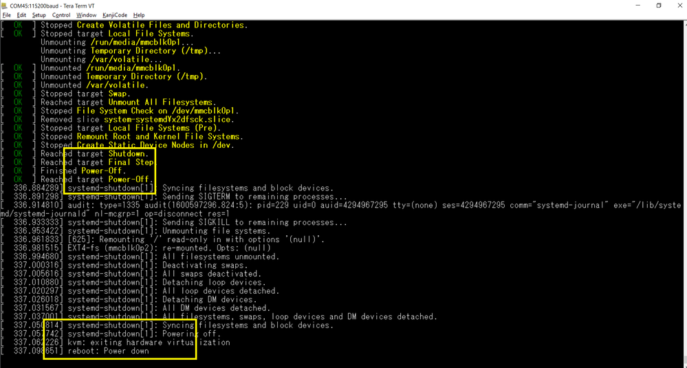

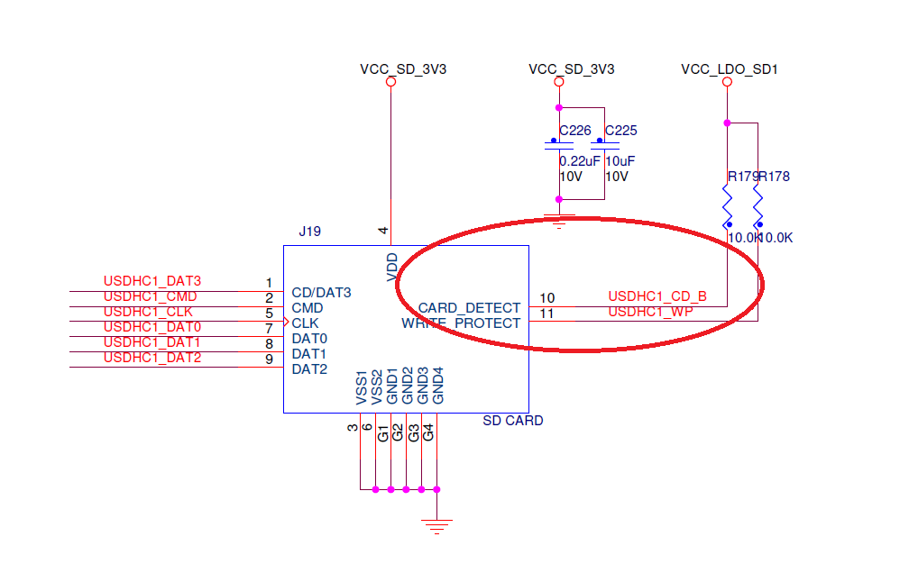

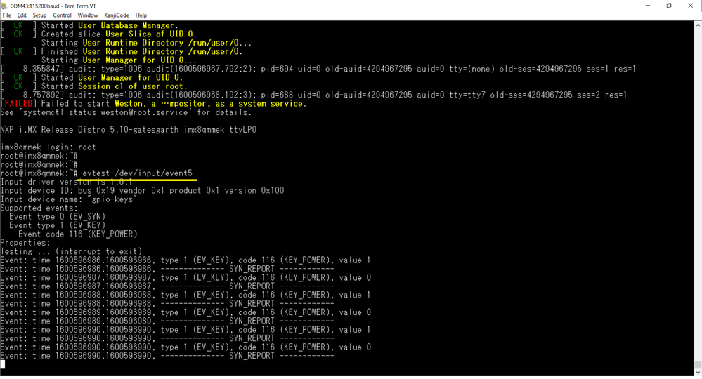

event check:
plugin sdcard to tigger the pin(sdcard CD, now it is LSIO_GPIO5_IO22 )
check the power off:
1. modify the /etc/systemd/logind.conf and restart systemd or reboot the board
#KillExcludeUsers=root
#InhibitDelayMaxSec=5
HandlePowerKey=poweroff
# i.MX-specific
#HandlePowerKey=ignore
#HandleSuspendKey=suspe
2. plugin sdcard to tigger the pin(sdcard CD, now it is LSIO_GPIO5_IO22 )
9,649件の閲覧回数
