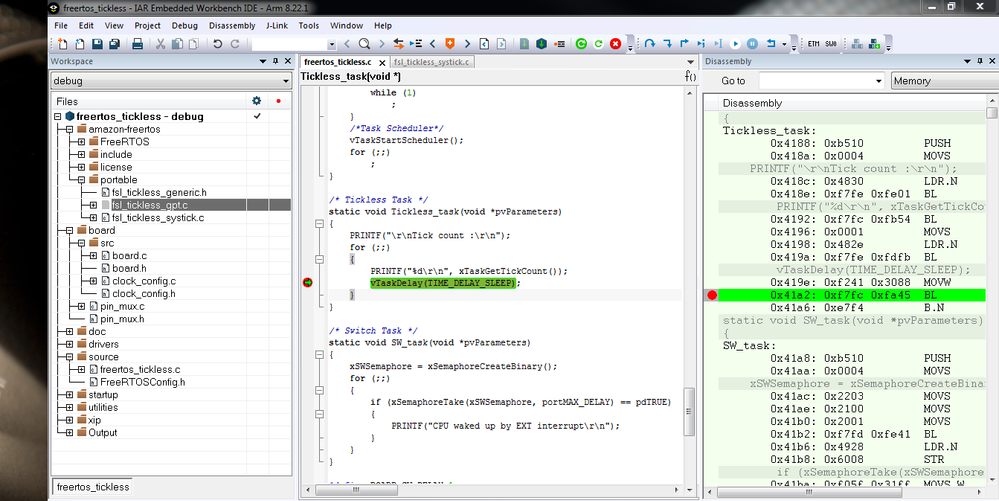

I'm using MIMXRT1051CVL5B with latest SDK (SDK_2.3.1_EVKB-IMXRT1050), but when i enable configUSE_TICKLESS_IDLE feature, and run example project SDK_2.3.1_EVKB-IMXRT1050\boards\evkbimxrt1050\rtos_examples\freertos_tickless, freeRTOS will crash when wait by VTaskDelay(), and jump to unknown address (0x50xxxxxx), i have tried others projects in SDK like power_mode_switch, it's the same, what's the matter?  see attached picture, thanks!

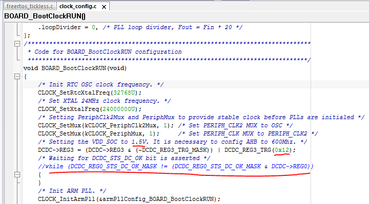

1. my code doesn't run in EVKB flash, but in internal RAM, so if CPU is in low power mode, but after reset, it should not be low power mode again.
2. even though CPU can't be woke up by SWD, but isn't it able to be woke up by any resource either? Tickless_task() never run again. Normally, it should be run over and over again every each 5s. see attached image
3. change the code as you said, are there any effects? it's in main(), and not yet start any tickless thread.

by the way, BOARD_BootClockRUN() always waiting for DCDC_REG0_STS_DC_OK_MASK to be set 1, our board connects VDD_SOC to 1.2V power and DCDC_REG0_STS_DC_OK_MASK is always 0, so i commented out this waiting condition, does it result in this issue? could you look at the pictureCapture.PNG?

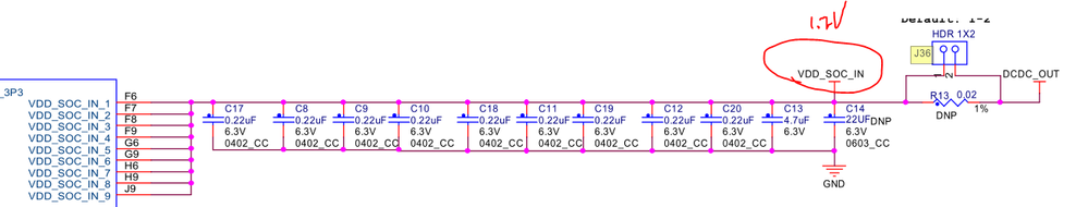

Everything is fine, but when I changed VDD_SOC_INx to 1.2v by setting DCDC_REG3 (see below code and schematic), sleep mode made system crashed.
The best important thing is that EVKB board never works fine once sleep mode crashed, whatever set VDD_SOC_Inx to 1.25v, 1.2v or 1.5v, it’s consistent, sleep mode always crashed! Never works again.

  1.        Open the latest SDK project (SDK_2.4.0_EVKB-IMXRT1050\boards\evkbimxrt1050\rtos_examples\freertos_tickless)
  2.        Build and run the project (excluding fsl_tickless_gpt.c, but using fsl_tickless_systick.s. I also tried fsl_ticless_gpt.c to build, it’s the same)Capture.PNG
  3.        Stop at here then run over vTaskDelay(), it makes system enter sleep mode and also crashed, sometimes I found it crashed at __WFI() in function vPortSuppressTicksAndSleep()
