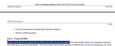

igorpadykov
Hi Devendra
frame buffer support for i.MX8 in nxp bsps is described in   i.MX Linux Reference Manual​   below
igor
