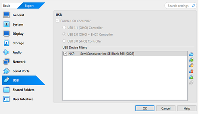

I tried the solution, but flashing with UUU was still unsuccessful. I used VirtualBox to run my terminal and setup NXP OTG USB with USB2.0 controller in VirtualBox. I suspect the problem in my case was caused by losing the connection with NXP OTG after "Run Fast Boot" started. Can you help me to resolve the issue? Thanks.

ash_
Hi @KLuis ,
I had the same problem with my locally built image for the nxp evk. After I reconnected the serial usb connection to my VM again while keeping the uuu console uninterrupted , the flashing of the image restarted automatically. And l could boot into the image. I was wondering if you figured out the problem.
