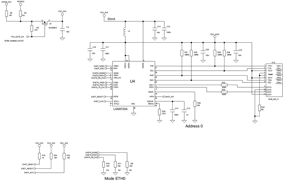

After a lot of testing, I think the problem may be this:
in my board I connected LAN8720A (Ethernet) at VDDIO 3V3 via mosfet (VDDIO: internal 3V3 iMX voltage regulator). So I think, when I turn on LAN via (GPIO2_15 like in iMX28 demo board), the 10 uF capacitor connected at LAN power supply resets the microcontroller. This behavior is not in all my boars but this depends to components tolerance.
With oscilloscope, in effect, I see a complete iMX reset and in duart log I don’t see anything (like you can see).
If I connect LAN transceiver directly to 3V3 power supplier (external regulator) all goes well. I tried tens of reboot and I never see any problem.

weidong_sun
Hello,Emanuele,
     That's to say, you control 3.3V power via MOSFET by a GPIO to supply LAN8720A ? Right ? Could you share your schematic of LAN8720A here ?
Weidong

emanuelec
This is a snapshot of my schematic.
NOTES:
NU = not mounted
VDDIO_3V3 = 3V3 power supply
REG3V3 = internal iMX28 regulator
FEC_PWR_EN = GPIO2.15
cid:[email protected]
The configuration is the “wrong” configuration. Removing R5 and mounting R4 LAN will be connected directly to 3V3 external regulator (“good” configuration, I hope…). The last one configuration is the same configuration used in the iMX28 demo board.

weidong_sun
Hello,Emanuele,
     in your bootloader, I think you should pull FEC_PWR_EN down to LOW as early as possible. For example , if you use u-boot, you can try to do it in lowlevel_init.S.
Weidong
10,199 Views
emanuelec
Yes, this is correct. But by default at startup this pin is in high impedance and bootloader don’t touch this configuration (I use iMX28 bootlet) and I don’t need LAN in bootloader. In addition to this, to avoid the problem that you say, I used pullup resistor (see RR8 connected to VDDIO_3V3).
