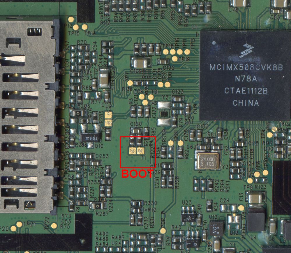

Forgive me intrusion to this very specific area I am not a microcontroller programmer and hope not to boring you with my problem.
I have a ereader device with Freescale i.MX508 cpu. After unfortunate upgrading my device hangs at the end of the booting process. I can hard reset it so it reboots again, but it does not offers anymore access to internal storage for PC.
I don't want to hack it, but I need to access the internal memory so I can copy the right firware there to try upgrading again.
... after some googling I got the idea:
1) get into specific BOOT_MODE for USB downloader
(Source IMX50CEC.pdf, Page 16)
 1a) There seems to be no Magic Key like for other devices or I did not found it
 http://wiki.mobileread.com/wiki/Kindle_Touch_Hacking)
 1b) But there are "Boot Mode Points" which maybe "shortened"
 (http://www.flickr.com/photos/eevblog/5963155318/in/set-72157627127757905)
2) Installing the XP Drivers. Maybe I can use the i.MX53/51 driver.
(http://imxcommunity.org/group/manufacturing-tool-mfgtool)
3) Getting access to device through MfgTool and enabling "diags mode"  to get access to Internal Storage
(http://www.mobileread.com/forums/showthread.php?t=169645)
4)Copying the firmware
So this was the idea. I don't know if it works. Would like to hear your opinions if there
are mistakes.
I have trouble to get into USB Downloader mode because I have no idea how I should proceed with the Boot Mode Points.
Maybe somebody can give me a hint?

On the main PCB next to the SD card slot, you have two pads labeled "T1".
1 ) Disconnect the battery
2 ) Connect the two "T1" pads with tweezers
3 ) Connect the USB cable to the USB 2.0 socket on the PC
4 ) Connect the USB cable to the device
5 ) Disconnect the tweezers

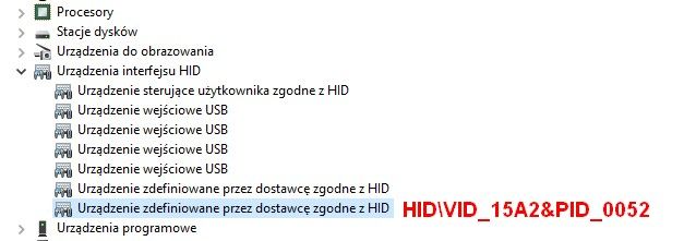

6 ) Connect the battery
7 ) The system will detect and install drivers for windows 10
8 ) The device will be detected as NS Blank CODEX
HID VID_15A2&PID_0052.jpgHID VID_15A2&PID_0052.jpgBOOT.jpgBOOT.jpgNS Blank CODEX.jpgNS Blank CODEX.jpg
