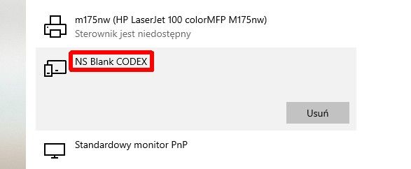

On the main PCB next to the SD card slot, you have two pads labeled "T1".
1 ) Disconnect the battery
2 ) Connect the two "T1" pads with tweezers
3 ) Connect the USB cable to the USB 2.0 socket on the PC
4 ) Connect the USB cable to the device
5 ) Disconnect the tweezers
6 ) Connect the battery
7 ) The system will detect and install drivers for windows 10
8 ) The device will be detected as NS Blank CODEX
