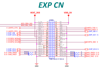

I am new to NXP IMX8 Processors. I am working on i.MX 8M Nano Evk, I have to enable GPIOs (any two) and simply set it to HIGH/LOW.
In the schematic if we check  the header J1003 we can see the information related to pins that are physically available to use. Here I am not using UART, so the pins UART3_CTS and UART3_RTS are also named GPIO.7 & GPIO.0 respectively, I want them to use it as regular gpios.

  1. Here https://variwiki.com/index.php?title=MX8M_GPIO#Pin_Func_files it says to set GPIO4_21
    gpioset gpiochip3 21= 1
    But as per schematic it is UART3_CTS (GPIO.7)  & UART_3RTS(GPIO.0),  How can I find which GPIOs are actually available on the header ? and what would be the correct gpiochip and its line number for the GPIOs, where can I find these details?
  2. Is there a standard steps or procedure for enabling  and using the GPIO in i.MX8 evk ?
1,244 Views
k_specka
Abit late but... UART3_CTS and UART3_RTS have no alt mode for gpio when the mini reference is right
