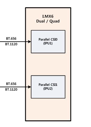

Is it possible to recieve 2ch, 720p@30fps, BT.656, 4:2:2 format, 54MHz, each CSI port of I.MX6DUAL?
I think it can because there are two IPU units.
what do you think, experts?

  Basically up to three cameras may be connected to the i.MX6 D/Q.
Please refer to Figure 9-3.(The Video Input Ports) of the i.MX6 D/Q RM.
  According to section 9.2.1.1 (Camera Ports) :
"The input rate supported by the camera port is as follows:
• Peak: up to 240 MHz (values/sec)
• Average (assuming 35% blanking overhead), for YUV 4:2:2
• Pixel in one cycle (e.g. BT.1120): up to 180 MP/sec, e.g. 12M pixels @ 15 fps
• Pixel on two cycles (e.g. BT.656): up to 90 MP/sec, e.g. 6M pixels @ 15 fps."
