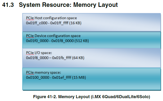

I'm working for driver porting PCIE device driver from x86 to ARM on Yocto kernel 3.14.52.
Our PCIE device will request BAR with MMIO and Port IO address. Our driver will use inb()/outb()
to access the PCIE device on X86. But we cant use the same method inb()/outb() with on IMX6.
when I use inb()/outb() will read all 0.
I had tried with pci_iomap() & ioread8() to do read. It's the same all 0. How should I do to read
the PCIE IO port data ?
The resource map is following:
root@imx6qsabresd:/sys/bus/pci/devices/0000:01:00.0# cat resource
0x0000000000001080 0x000000000000108f 0x0000000000040101
0x0000000001100000 0x000000000110000f 0x0000000000040200
0x0000000000001000 0x000000000000101f 0x0000000000040101 <---
0x0000000000001020 0x000000000000103f 0x0000000000040101
0x0000000000001040 0x000000000000105f 0x0000000000040101
0x0000000000001060 0x000000000000107f 0x0000000000040101
0x0000000000000000 0x0000000000000000 0x0000000000000000

lmendes
Linux Kernel ARM port does not allow accessing PCI I/O resources in SYSFS (including Kernel 4.1.15), because:
/drivers/pci/pci-sysfs.c - function static int pci_mmap_resource(struct kobject *kobj, struct bin_attribute *attr,
                 struct vm_area_struct *vma, int write_combine)
calls pci_mmap_page_range(pdev, vma, mmap_type, write_combine);
with mmap_type=pci_mmap_io when PCI RESOURCE is IO...
which for ARM is defined in /arch/arm/kernel/bios32.c, like this:
int pci_mmap_page_range(struct pci_dev *dev, struct vm_area_struct *vma,
            enum pci_mmap_state mmap_state, int write_combine)
    if (mmap_state == pci_mmap_io)
        return -EINVAL;
     * Mark this as IO
    vma->vm_page_prot = pgprot_noncached(vma->vm_page_prot);
    if (remap_pfn_range(vma, vma->vm_start, vma->vm_pgoff,
                 vma->vm_end - vma->vm_start,
                 vma->vm_page_prot))
        return -EAGAIN;
    return 0;
27,238 Views

peterhong
Following t sysfs - resource
0/2/3/4/5: IO resource
1: MEM Resource
root@imx6qsabresd:/sys/bus/pci/devices/0000:01:00.0# ls
broken_parity_status      enable         macro     resource   subsystem
class                     io             modalias  resource0  subsystem_device
config                    ioport_map     msi_bus   resource1  subsystem_vendor
consistent_dma_mask_bits  ioremap        power     resource2  uevent
device                    irq            remove    resource3  vendor
dma_mask_bits             local_cpulist  rescan    resource4
driver                    local_cpus     reset     resource5
I had tried with your code with some modification to read resource 0~5. It's only able to access resource 1 (MEM)
others are failed. (mmap return -1)
my code:
#include <stdio.h>
#include <stdlib.h>
#include <sys/types.h>
#include <sys/stat.h>
#include <fcntl.h>
#include <sys/mman.h>
int main(int argc, char* argv[]) {
    int fd;
    int i;
    unsigned char *ptr;
    fd = open("/sys/bus/pci/devices/0000:01:00.0/resource1", O_RDWR | O_SYNC);
    printf("fd:%d\n", fd);
    if (fd < 0){
        return 0;
    ptr = mmap(0, 8, PROT_READ | PROT_WRITE, MAP_SHARED, fd, 0);
    printf("ptr:%d\n", ptr);
    for (i = 0; i < 8; ++i)
        printf("0x%4x\n",  *(ptr + i));
Could I access PCIE IO Resource with iMX6?

My PCIE device had allocated PCI IO Space with BAR0/2/3/4/5. According from the Freescale document,
the PCIE io space is start from 0x01f0_0000 to 0x01f8_0000. I had used devmem2 to read memory
0x01f0_0000 + 0x1020 or 0x01f8_0000 + 0x1020. The devmem2 will always report "BUS error".
How should I do to read the PCIE IO Space ?

devmem2
root@imx6qsabresd:~/ddd/freescale/data# ./devmem2 0x01f01020 b
/dev/mem opened.Unhandled fault: external abort on non-linefetch (0x1018) at 0x76f32020
Memory mapped at address 0x76f32000.
Bus error
root@imx6qsabresd:~/ddd/freescale/data# ./devmem2 0x01f81020 b
/dev/mem opened.Unhandled fault: external abort on non-linefetch (0x1018) at 0x76f24020
Memory mapped at address 0x76f24000.
Bus error

Please refer to the Chapter 41 of the attached document for the details on the L3.14.52 BSP PCIe driver. Most likely, the PCIe Root Complex configuration is not built into the kernel by default. Refer to the document attached for the information on how to build-in/enable it.
Artur
27,222 Views
