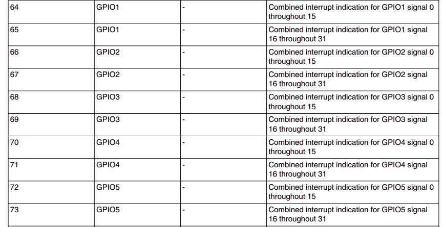

Hello @willvio
I hope you are doing very well.
You can check if you have another gpio that can activate the IRQ, because you can see on reference manual of i.MX8MP the GPIOs IRQs are combined between 0-15 and 16-31 bit:
Salas.
