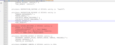

Hi @jensseifr
In the RT1170 we  have  the Chip Silicon Version Register (MISC_DIFPROG)
For boundary scan (over JTAG) we have (talking just about RT1060) identification registers. Just search for the .bsdl file for your targeted part (NXP symbols and footprints) See the IDCODE register.
Does this works for you?
Diego.
