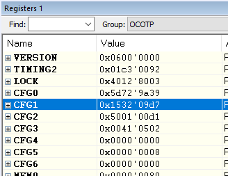

Unfortunately it doesn´t help, as i searched a chip register to read out during runtime by our 2nd Bootloader.
It´s written in the RM that there is an unique ID in the OCOTP-Register, but its not said where exactly to find and how to interprete this value.
Having a look at OCOTP by register view with IAR EWARM only the subregisters CFG0 to CFG6 hold values which may can be interpreted as such an ID. And these registers are described as "Configuration and Manufacturing Info" by the workbench.jensseifr_1-1664437783479.png
But i miss Information to interpret this values in the datasheets.
May those values contain what im looking for? If so can you help to interprete them?
A full register description of every bit(group) would be helpfull.
Best Regards Jens

RT10xx doesn't contain standard part id register, so you cannot read register to know it is RT106x, we have to use some tricky way:
ID register in RT10xx  can be used to detect family part (actually is means silicon version by time), but not for phantom part (eg, RT1061 or RT1062)
  • RT1011 - RT1010 family
  • RT1015/1021/1024 - RT1020 family
  • RT1051/1052 - RT1050 family
  • RT1061/1062/1064 - RT1060 family
i.MXRT ID register ID register value
i.MXRT1011 USB_ANALOG->DIGPROG 0x006D0000
i.MXRT1015 USB_ANALOG->DIGPROG 0x006B0000
i.MXRT1021 USB_ANALOG->DIGPROG 0x006B0000
i.MXRT1024 USB_ANALOG->DIGPROG 0x006B0000
i.MXRT105x USB_ANALOG->DIGPROG 0x006A0001
i.MXRT106x USB_ANALOG->DIGPROG 0x006C0000
i.MXRT1064 USB_ANALOG->DIGPROG 0x006C0000
Just a little note :The CFG0&CFG1 is i.MX RT device UID (64bits), it is different on each chip.
