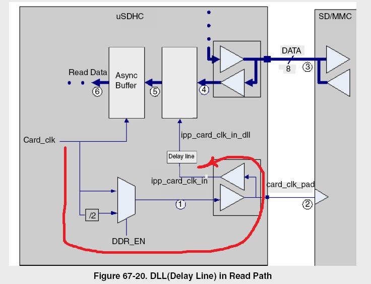

Hi all
Please tell me a "DLL in read path" in uSDHC controller.
I have question about function, clock root and usage instructions.
I'm watchin Figure 67-20 in following document.
http://cache.freescale.com/files/32bit/doc/ref_manual/IMX6SDLRM.pdf
What is a function of the box that is between ④ and ⑤ ?
I can't understand their clock root because their some difference between Figure 67-2 and 67-20.
In my understandig, the clock that is shown in ① in Figure 67-20 is ref_clk.
Is it correct ?
Does it change their name to "ipp_card_clk_in" ?
According to the descrition of DLL, the DLL can be disabled or bypassed.
What is different between disabled and bypassed ?
Is the read path same that is shown in Figure 67-20 when user disabled or bypassed the DLL ?

Hi Yuri
Thank you for reply but I want to confirm more.
> "ipp_card_clk_in" is internal signal - from "card_clk_pad"
I can't understand that it comes from card_clk_pad.
The card_clk_pad is output, isn't it ?
Does both ipp_card_clk_in and card_clk_pad are divided from card_clk ?
I read uSDHCx_DLL_CTRL field descriptions and understand it as below.
Is it correct ?
DLL Enable    = Automatically adjust  Set DLL_CTRL_SLV_OVERRIDE field to "0" and DLL_CTRL_ENABLE field to "1"
DLL Bypass = Manually adjust         Set DLL_CTRL_SLV_OVERRIDE field to "1" and DLL_CTRL_ENABLE field to "0"
DLL Disable = No adjust                  Set DLL_CTRL_SLV_OVERRIDE field to "0" and DLL_CTRL_ENABLE field to "0"
Ko-hey

Hello !
Please look at my comments below.
1.
> What is a function of the box that is between and ?
  This is a latch register.
2.
> In my understandig, the clock that is shown in in Figure 67-20 is ref_clk.
> Is it correct ?
  The clock  is a derivative of “Card_clk”, mentioned on both figures 67-20 and 67-2.
2.1.
“ipp_card_clk_in” is internal signal - from “card_clk_pad” (SDx_CLK of SD interface).
3.
  According to section 67.5.3.2.4 [DLL (Delay Line) in Read Path] of the RM,
“The reasons why the DLL is needed for uSDHC are 1.) the path of read data traveling
from card to host varies. 2.) in SD/MMC DDR mode the minimum input setup and hold
time are both at 2.5 ns. The data sampling window is so small that the delay of loopback
clock needs to be accurate and consistent regardless of PVT”.
  The DLL is needed for high frequency cases, in particular for the DDR mode.
4.
Basically – yes. But “ipp_card_clk_in_dll” “and ipp_card_clk_in” are the same : the “delay line”
is skipped.
Yuri

Yuri
> Is it correct ?
Yes.
~Yuri.
