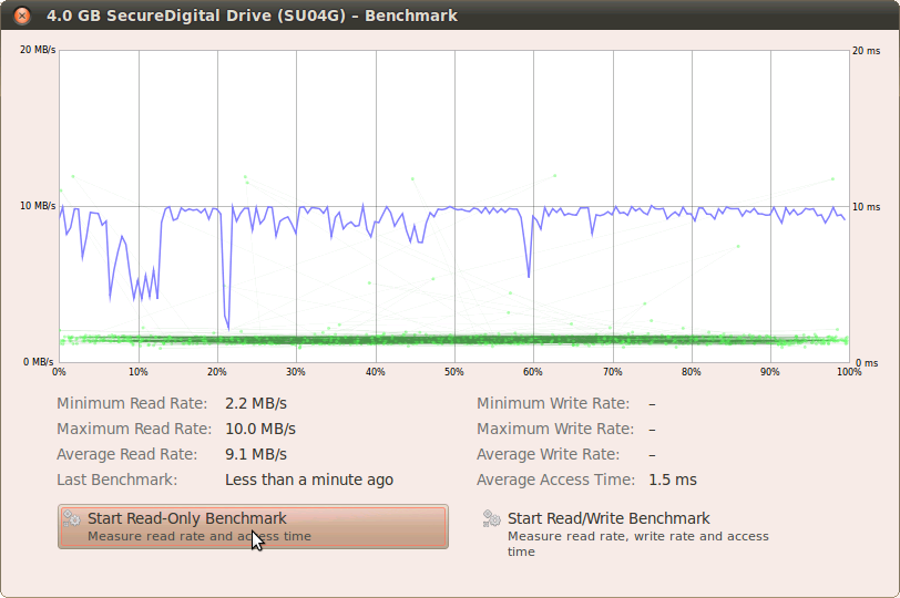

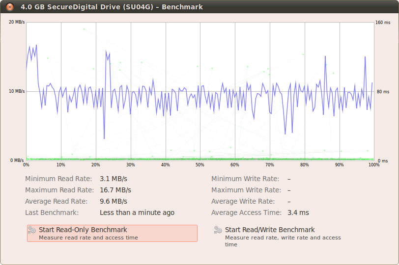

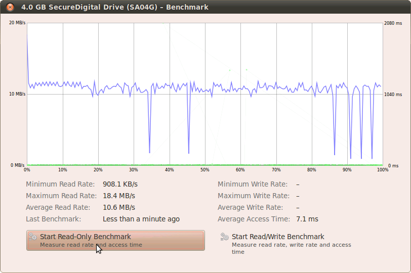

Firefox load time on SD cards
Transcend (Class 2) 4GB - 9s
Sandisk (Class 2) 4GB - 10s
Kingston (Class 2) 4Gb - 21s
Transcend Benchmark
SanDisk Benchmark
Kingston Benchmark
Unfortunately many of the i.MX53 QSBs were shipped with the Kingston, but I would now suggest to use a SD card with higher minimum transfer rate such as the Transcend or SanDisk.
