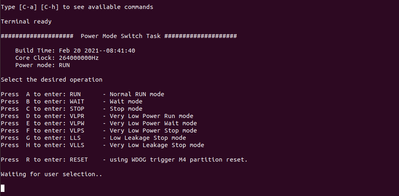

Thank you so much for the confirmation. I attempted to debug the Cortex-M4 using an MCUXpresso SDK demo, specifically the 'hello world' application. I connected the Segger J-Link and utilized the JLinkGDBserver and client. Successfully, I could observe the 'hello world' prints over /dev/ttyUSB2. However, the binary for the Cortex-M4 is not being updated. After rebooting, I am encountering the following prints over /dev/ttyUSB2.I have followed  mcuxpresso sdk guide.
Screenshot from 2024-02-09 20-01-23.pngScreenshot from 2024-02-09 20-01-23.png
 Is it possible to update the M4 demo bin in emmc using the Jlink? Is there any Document to refer for debugging a35 cortex using debugging tool?

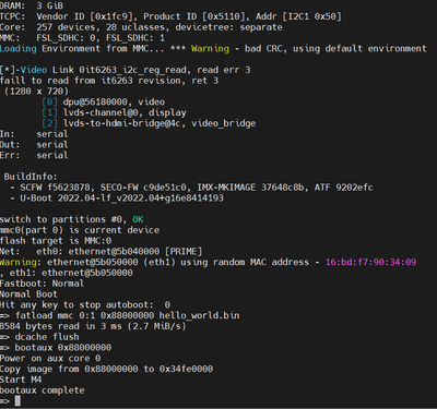

jnj
Hi @Chavira ,
I have used the above mentioned uuu command over USB  to flash the hello_world.bin to emmc .I could flash the hello_world.bin to emmc vfat partition using the below command.
./uuu -b fat_write hello_world.bin mmc 0:1 hello_wrold.bin
After flashing I can see the hello_world.bin inside the mount point of mmcblk0p1 ie : /run/media/boot-mmcblk0p1
But while loading I am getting the below error

Chavira
Hi @jnj !
Try to corroborate if the image was flashed correctly using the command "fatls mmc 0:1", that command shoul list all the files saved in fat partition.
After that you have to use the commands
=>fatload mmc 1:1 0x88000000 hello_world.bin
=>dcache flush
=>bootaux 0x88000000
Best Regards!

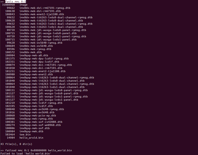

jnj
Hi @Chavira ,
I have checked the list of files in fat partition using the above mentioned command .The hello_world.bin file is showing in the list.But it throws an error when the hello_world.bin is tried to load as shown below
16,480 Views
Chavira
Hi @jnj!
can you try again?
I don´t get errors.
Try with this binary
Best Regards!

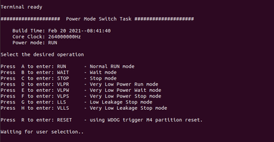

jnj
Hi @Chavira ,
Still I am facing the issue.As I discussed erlier ,already M4 core in my device is up and working .I am getting the following prints over /dev/ttyUSB2
Screenshot from 2024-02-20 14-53-31.pngScreenshot from 2024-02-20 14-53-31.png
 Could it be that I am unable to update the hello_world.bin because M4 is already up and running?And also I tried to see the debug prints of scu over /dev/ttyUSB1 and /dev/ttyUSB3 by turning on the switch SW4 in the imxqxp mek.But I couldn't see any uart prints .Do I need to enable anything from the scu fw.If yes could you please help me to get the scu fw link?

I will check this document. Regarding the M4 binary update, I downloaded the L5.15.71_2.2.1 pre-built binaries and flashed them using the following command:
./uuu 5.15.71_2.2.1.zip
After that, I attempted to update the M4 binary [hello_world.bin] by following the specified steps. While loading the binary using "fatload", I could see the print over /dev/ttyUSB2. However, my intention is to run the binary on every reboot of the device.
Previously, I flashed the Yocto image using the command:
./uuu -b emmc_all imx-boot-imx8qxpc0mek-sd.bin-flash_linux_m4 imx-image-full-imx8qxpc0mek-20240213094507.rootfs.wic.zst
If we flash using the above command, a sample code [power_mode_switch.bin] will be running on the M4 core.Since this bin is running,I was not able to fatload the hello_world.bin.
To make hello_world.bin runnable on every reboot I created flash.bin using the mkimage tool[make SOC=iMX8QX REV=c0 flash_linux_m4] and created flash.bin is flashed using ./uuu -b emmc imx-boot-imx8qxpc0mek-sd.bin-flash_linux_m4  flash.bin and it is was updated and on every reboot this binary is running on m4 cortex.
Previously, I attempted to flash it using the command:
./uuu flash.bin.
However, it was not running on the M4 core. I am a little confused about the interpretation of the binary name. Why did ./uuu flash.bin not update the binary, and why did the following command update the binary:
:/uuu -b emmc imx-boot-imx8qxpc0mek-sd.bin-flash_linux_m4  flash.bin ?
16,097 Views
Chavira
Hi @jnj!
The uuu tool only flashes the first binary, in this case the first binary is "imx-boot-imx8qxpc0mek-sd.bin-flash_linux_m4", probably you don't include the M4 binary when you create the flash.bin
In this case I recommend using a flash.bin without an m4 binary, in this way you can upload a new m4 binary to test your application or use the debugger without problems.
To include the m4 image on the flash.bin image you should put the m4 binary with the name "m4_image.bin" to imx-mkimage/iMX8QX/.
Once all the needed binaries are inside of the folder iMX8QX you have to compile using the command "make SOC=iMX8QX flash_linux_m4" to create the correct flash.bin with the updated m4 image.
