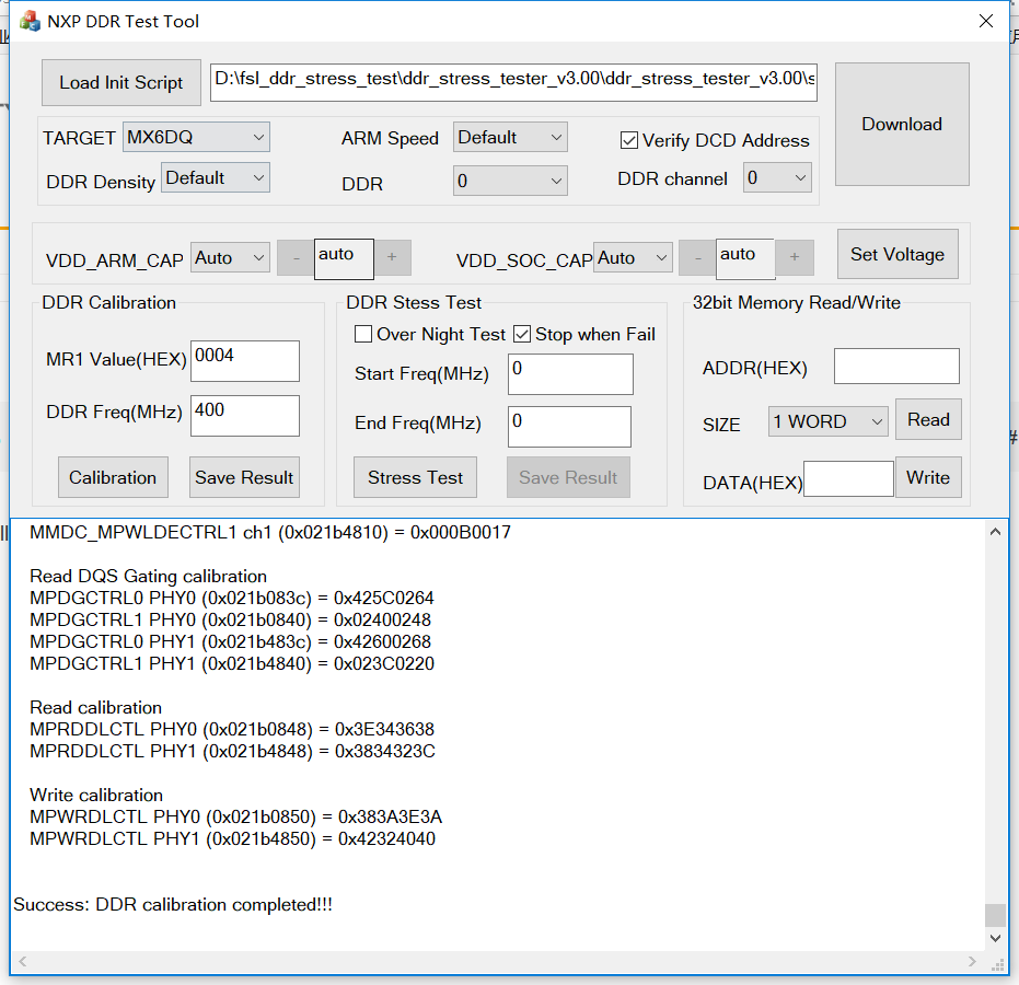

I follow the option 1 in this file.i.MX6/7 DDR Stress Test Tool V3.00
my config like this and calibration success.But I don't known if this is right setup.
I known need write calibration parameter write into flash_header.S.Is there any documentation on how to write it?I don't understand how to modify this file.
thanks!

Hi wang
there is no documentation for changing flash_header.S, it is necessary
to check Reference Manual with description of MMDC registers, also may be useful
Freescale i.MX6 DRAM Port Application Guide-DDR3
