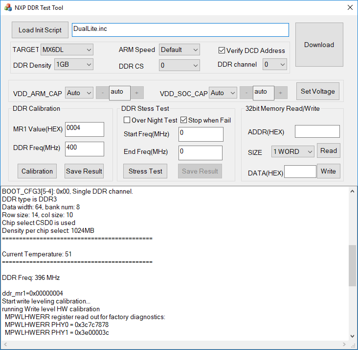

Some time ago I used DDR_Stress_Tester_V1.0.3 in a custom board without issues. Recently, in a new board I used the same version without issue neither.
I just decided to update the tools to ddr_stress_tester_v2.92 and the application shows HW WL cal status: no suitable delay value found for byte 5 and later Error: failed during write leveling calibration.
Appreciated any suggestion.
Below more details:
BOOT_CFG3[5-4]: 0x00, Single DDR channel.
DDR type is DDR3
Data width: 64, bank num: 8
Row size: 14, col size: 10
Chip select CSD0 is used
Density per chip select: 1024MB
Current Temperature: 51
DDR Freq: 396 MHz
ddr_mr1=0x00000004
Start write leveling calibration...
running Write level HW calibration
 MPWLHWERR register read out for factory diagnostics:
 MPWLHWERR PHY0 = 0x3c7c7878
 MPWLHWERR PHY1 = 0x3e00003c
HW WL cal status: no suitable delay value found for byte 6
Write leveling calibration completed but failed, the following results were found:
 MMDC_MPWLDECTRL0 ch0 (0x021b080c) = 0x00430043
 MMDC_MPWLDECTRL1 ch0 (0x021b0810) = 0x0033003B
 MMDC_MPWLDECTRL0 ch1 (0x021b480c) = 0x001F0024
 MMDC_MPWLDECTRL1 ch1 (0x021b4810) = 0x001C001F
Write DQS delay result:
 Write DQS0 delay: 67/256 CK
 Write DQS1 delay: 67/256 CK
 Write DQS2 delay: 59/256 CK
 Write DQS3 delay: 51/256 CK
 Write DQS4 delay: 36/256 CK
 Write DQS5 delay: 31/256 CK
 Write DQS6 delay: 31/256 CK
 Write DQS7 delay: 28/256 CK

Hi Igor,
Taking in consideration that the board has pass the DDR calibration with version 1.0.3 and also DDR testing under controlled environmental conditions (-10 to 45C) during 24hr (to mention a few), any thought or suggestion regarding this situation with 2.92 version?
I could use previous version and support my production decisions on additional testing, but I would like to be sure I'm not dismissing a possible issue based on the improved new tool revision.
2,773 Views
igorpadykov
Hi Julio
if boards are working fine with parameters got from version 1.0.3
one can stay with them.
igor
2,773 Views
igorpadykov
Hi Julio
old version did not have ICache and DCache turned on, so newer version provide
more accurate results. You can try to increase WALAT and verify ddr layout with
recommendations given by i.MX6 System Development User’s Guide
https://www.nxp.com/docs/en/user-guide/IMX6DQ6SDLHDG.pdf
igor

juliocruz
Hello Igor,
Thanks for your feedback and suggestion.
For the version 1.0.3, I used the guide Freescale i.MX6 DRAM Port Application
Guide – DDR3.
Please, may I know which documentation is available for the 2.92 version?
According with your suggestion, I would need to check further details.
  • About the suggested guide, I review it a lot. In other hand, I had been using previous boards (with same layout) without issues.
  • About the WALAT suggestion, the default value of WALAT is 1. After set to 2 and 3, the results are similar: no suitable delay value found for byte 5 and 6.
Regards and Thanks,
Julio
2,773 Views
juliocruz
After re-check again the post by Oliver Chen at i.MX6/7 DDR Stress Test Tool V2.92, I wondering if the error during my testing has something to do with fix in previous release 2.91:
  • Resolved issue with write leveling calibration code where a race condition in the code may result in the calibration routine not being able to find any delay values.  Only applies to MX6 series SoCs that support DDR3.
