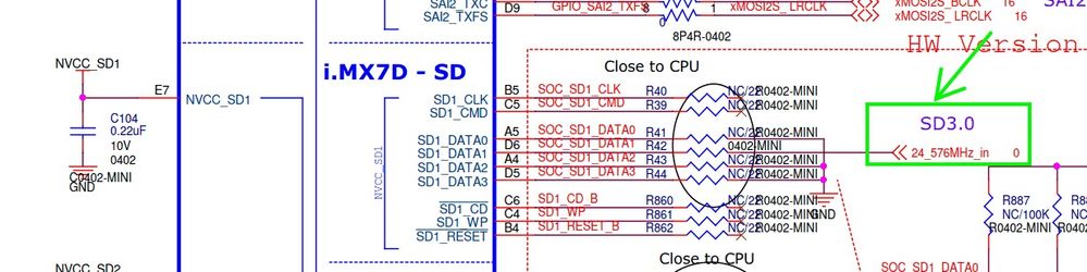

The customer system is dual board design.
A board is Other brand CPU+OSC
B board is i.MX7D+XTAL
They shared A board's OSC clock channel to i.MX7D external clock input.
 The configuration in kernel: SD1_DATA1 => CCM_EXT_CLK2

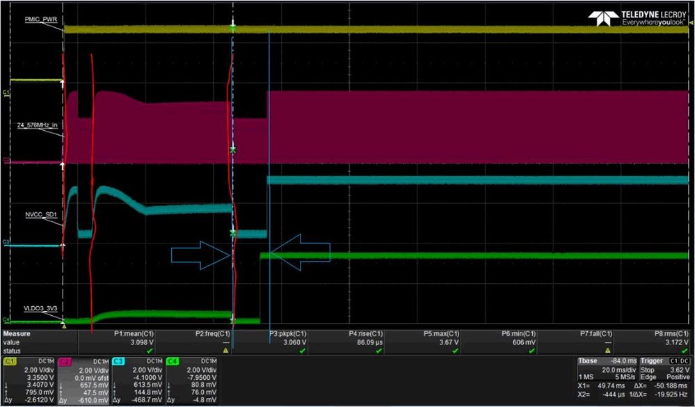

But the power time slot of A board is earlier than B board.
So SD1_DATA1 has clock input from A board OSC before i.MX7D start its power on sequence.
It causes current leakage into the other two pins(NVCC_SD1 & VLDO3_3V3).
Signal of SD1_DATA1 (Red)
Signal of NVCC_SD1(Blue)
Signal of VLDO3_3V3(Green)
The customer would like to know what is the side effect under this condition.

   Section 4.1.11 (Power supplies usage) of the i.MX7 Datasheet (IMX7DCEC,
Rev. 5, 07/2017) states: "I/O pins should not be externally driven while the I/O
power supply for the pin (NVCC_xxx) is OFF. This can cause internal latch-up
and malfunctions due to reverse current flows."
