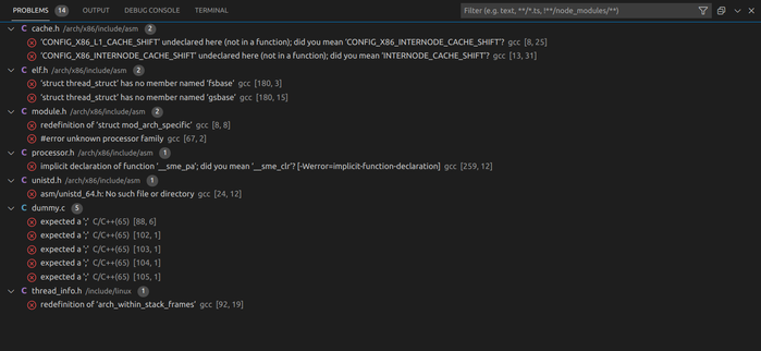

I want to build device driver with the same method, but I have difficulties about setting kernel headers.
When I bitbake, I added the following to my recipe to include kernel source to sdk which generated by populate_sdk.
TOOLCHAIN_TARGET_TASK_append = " kernel-devsrc"
I made dummy device driver 'dummy.c' in https://github.com/PacktPublishing/Mastering-Embedded-Linux-Programming-Second-Edition/blob/master/C...
With dummy.c, I run 'make' and VScode show me lots of errors. I think I have to match kernel header carefully, but I don't know how to do.
 The following figure is errors which VScode shows to me.

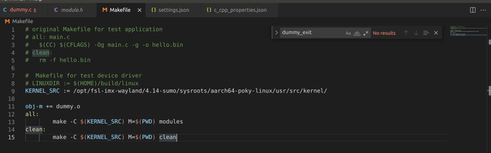

The following figure is my c_cpp_properties.json in VScode and my SDK's location is '/opt/fsl-imx-wayland/4.14-sumo/sysroots/aarch64-poky-linux/*'.
The following figure is my Makefile in VScode.

   VSCode can be used for development of relatively simple applications.
Hardly it is suitable for Linux driver design, since this area is very kernel / version
sensitive.   I think it makes sense to rely on standard approaches here.
Yuri.
