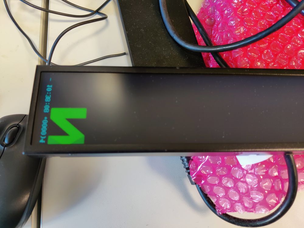

Hello everyone,
I have an IMX8QXP MEK board to which I connected a panel via the LVDS0 interface. I added support for the panel in board/freescale/imx8qxp_mek/imx8qxp_mek.c as shown below:
struct display_info_t const displays[] = {{
	.bus	= 0, /* LVDS0 */
	.addr	= 0, /* LVDS0 */
	.pixfmt	= IMXDPUV1_PIX_FMT_BGRA32,
	.detect	= NULL,
	.enable	= enable_lvds,
	.mode	= {
		.name           = "MYPANEL",
		.refresh        = 60,
		.xres           = 256,
		.yres           = 1920,
		.pixclock       = 13468, /* 74250000 */
		.left_margin    = 150,
		.right_margin   = 150,
		.upper_margin   = 20,
		.lower_margin   = 20,
		.hsync_len      = 72,
		.vsync_len      = 8,
		.sync           = FB_SYNC_EXT,
		.vmode          = FB_VMODE_NONINTERLACED
In u-boot, I configured the display like this:
=> setenv panel MYPANEL
=> saveenv
Now I can see the NXP logo during u-boot like shown in the picture below:IMG_20211123_132724.jpg
The issue here is that the logo is mirrored, so I need to flip it then rotate it (90°) clockwise.
So I edited video_hw_init(void) in arch/arm/mach-imx/imx8/video_common.c like this:
	imxdpuv1_init_channel_buffer(imxdpuv1_id,
		channel.common.chan,
		gmode.hlen * imxdpuv1_bytes_per_pixel(IMXDPUV1_PIX_FMT_RGB32),
		IMXDPUV1_ROTATE_90_RIGHT_HFLIP, /* rotation mode */
		(dma_addr_t)fb,
		0,
		0);
I found rotation modes are defined like this in include/imxdpuv1.h:
 * Enumeration of IMXDPU rotation modes
typedef enum {
	/* todo: these need to aligh to imxdpu scan direction */
	IMXDPUV1_ROTATE_NONE = 0,
	IMXDPUV1_ROTATE_VERT_FLIP = 1,
	IMXDPUV1_ROTATE_HORIZ_FLIP = 2,
	IMXDPUV1_ROTATE_180 = 3,
	IMXDPUV1_ROTATE_90_RIGHT = 4,
	IMXDPUV1_ROTATE_90_RIGHT_VFLIP = 5,
	IMXDPUV1_ROTATE_90_RIGHT_HFLIP = 6,
	IMXDPUV1_ROTATE_90_LEFT = 7,
} imxdpuv1_rotate_mode_t;
I tried different rotation modes but none has worked, it seems that screen rotation is not implemented. So what's the best way to achieve this? I need pointers.
