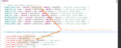

This is the SS of the Bootloader memory.ld file's memory region.
And below is the SS of our application memory region in memory.ld file;
this image shows that our application starts from 0x30200000 address in which we are trying to place our application's custom header of 64B. After this from address location 0x30200040 our application program will start.

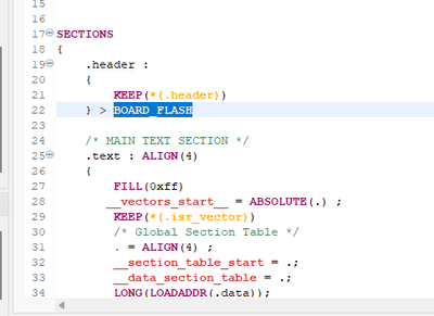

Above image shows the header section we have created in the debug.ld file.

I checked your application address, I think the addresses that I have boxed in the picture should all be the same.
#define APP_IMAGE_START_ADDRESS  0x30200000
For example,  you set  application address as APP_IMAGE_START_ADDRESS  ,  then the jump address should be following code shows (It's only for demo verification. For the actual project, it needs to be in accordance with your design requirements. ).
farewellBootloader = (void (*)(void))(APP_IMAGE_START_ADDRESS  + 4);
Please try it. I'm looking forward to your good news.

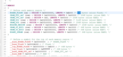

Also based on requirement changes, now I tried to start my application from location 0x3020_0040, but the VTOR register is not updating with this location. I did the necessary changes in the memory linker file. I attached the SS of the changes I did for the new requirement.
Please help me with the issue.

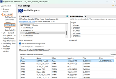

The MCUXPresso IDE will automatically generate the debug_memory.ld file.
You can change Flash, Ram size in this window.
I think this method is more reliable.
