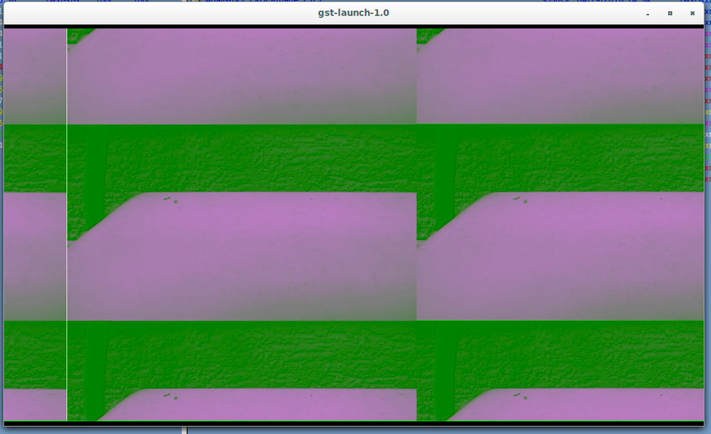

There is a camera with LVDS output connected to the THC63LVD1024 converter (1080p30 video format). The chip is connected to CSI0, Y to D12 ~ D19, CbCr to D2 ~ D9, using DATA_EN, VSYNC, HSYNC, PIXCLOCK.
The device tree is configured as follows:

And also the kernel files (attached) are edited, the patch was taken as a basis https://community.nxp.com/thread/314211
I tried to set CSI0 to bt.1120 mode. But I never managed to capture the video with gstreamer.
What am I doing wrong?

OK, I managed to get an image using the camera! It was necessary to turn off MX6QDL_PAD_CSI0_DATA_EN__IPU1_CSI0_DATA_EN to PAD_CTRL_HYS_PD . But now I have such an image (1080p30, V4L2_PIX_FMT_YUYV, IPU_CSI_DATA_WIDTH_8, IPU_CSI_CLK_MODE_GATED_CLK)

it seems the de-interlacing issue, pls check this document as below:

and I still do not understand what's wrong.

you can check if you set correctly according to the application note I sent, and what mode do you use? bt1120 progressive mode? and what bsp version do you use?try to use mxc_v4l2_tvin.out to test first.

I'm not sure what 2.8.2 you mean, the latest bsp version for imx6q is 4.9.11, refer to the application note I sent to you, the chapter 2.7 Clock Mode Setting in Driver, That reference code used “clock_curr = 0” for BT.656/1120 interlaced clock mode; “clock_curr =1” for BT.656/1120 progressive clock mode; “clock_curr = others” for gated clock mode. pls check if you set this correct or not, and pls find more detailed information from this AN

IPU_CSI0_SENS_CONF is configured as needed.
Sony 7520 camera is connected according to the diagram on page 64 (LVDS receiver circuit example  (Double output)), datasheet attached.
may I need to use v4l2-dv-timings? because it already is a digital video. hmm
