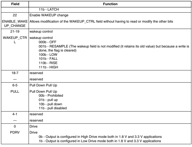

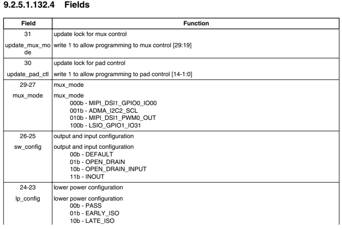

Is there a given sequence to write to register for changing the pin configuration?
For example if i want to write to MIPI_DSI1_GPIO0_00 register to set the mode to "000b".
Is the mux_mode field to set enough?
