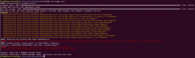

Hello everyone,
So I've tried on my IMX8MPEVK board, which is connected to a monitor using HDMI cable, using eMMC mode (0011) and why I cannot install PyQt5 package needed for my apps?  Any help is much appreciated! Thank you
2,495 Views
Hieuvu1995
I did as what they said that I should add one more line IMAGE_INSTALL_append + = " python-pyqt5", however this error showed up, any ideas?
2,492 Views
Zhiming_Liu
You need bitbake imx-image-full, only  imx-image-full contains qt5 and pyqt5.
Don't add IMAGE_INSTALL_append + = " python-pyqt5", already contained in imx-image-full
