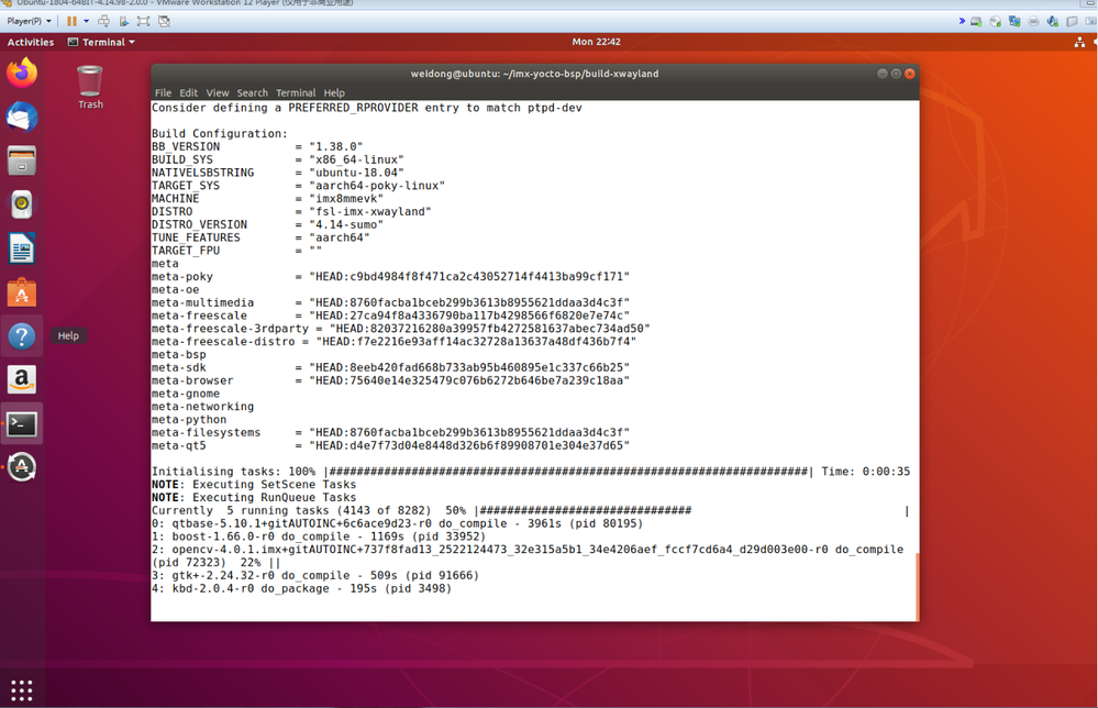

weidong_sun
Hi タイ チャン ,
    I compiled L4.14.98 BSP with QT , and added following line to local.conf.
    IMAGE_INSTALL_append + = " python-pyqt5" ( Note: before python-pyqt5, there is a space character)
    50% complete now, no error.
Try it , please!
Have a nice day!
