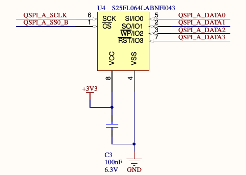

We are struggling to get u-boot to load from QSPI on our custom IMX7S board (based on MCIMX7S5EVK08SC). We have been desperately trying to work on this for several days. Would it be possible to have some advice on what we could be doing wrong?
This is what we have so far: We have booted u-boot via USB SDP and programmed the NOR flash with the QuadSPI configuration parameters at 0x400 0x0 (see update), and the u-boot image at 0x1000 0x400 (see update). We followed this post: How do we get the mx6ull evk to boot from QSPI NOR flash? and also used the same qspi-header.bin configuration parameters because they looked like they should at least be compatible (but perhaps not optimal).
The QuadSPI configuration parameters have been loaded and we can verify them as follows: (note 0x60000000 is the memory mapped address for the QSPI NOR flash - using sf read ... shows the same).

The fuses have been blown for the BOOT_CFG and BT_FUSE_SEL = 1:
=> fuse read 1 3
Reading bank 1:
Word 0x00000003: 10004000
Our BOOT_MODE[1:0] == 00 (both boot GPIO pins are tied to ground).
Schematic for the IMX7S
And QSPI flash:
100K pull ups on QSPI_A_DATA2/3

The problem was an error in the IVT as spotted by our fantastic FAE from Silica.
It turns out there was a problem with u-boot in the imximage.cfg and imximage.c parser.
For the IMX7 you need to set the BOOT_OFFSET to 0x400.
You would think that using "BOOT_OFFSET FLASH_OFFSET_STANDARD" in the .cfg file should be possible as in the documentation, but there is an include problem I could not quite figure out and imximage.c simply ignores that it cannot parse it and unhelpfully sets the offset to 0xF without warnings or errors.
Manually setting:
BOOT_OFFSET 0x400
solved it.
