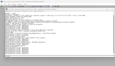

      I have a 8MP CPU with 4GB DDR. When the system is ready to enter WinPE, the system will crash.
      I use windbg to observe the problem. I see "Missing Image Name". I guess the problem is related to
DDR size?
Since i have an sd card with a windows 10 IoT image, I flashed the EVK bootloader in the sd card.
I can boot into WinPE normally. I only modify the DDR parameter in the same sdcard. The sd card is put
in my system, but the system will crash on boot wiepe screen.
Do you have any ideas?

Hi @hankwang,
can you please try to set the size of Bank1 to 0 as it was in W1.3.0?
giMX8TokenSpaceGuid.PcdBank1MemorySize|0x0000000000000000
While using signed firmware, you need to have written "RPMB write key" in eMMC, otherwise boot will fail. So if you do not need to use TPM, please use unsigned firmware.
Best Regards, Jakub

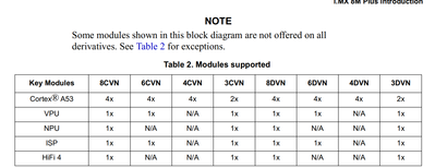

  1. can I please ask, what is your partnumber of i.MX8M Plus? There are the variants without the VPU and with only 2x A53 cores, on them the BSP will not work without removing VPU driver or setting correct CPU number.jakub_zigacek_0-1693987859998.png

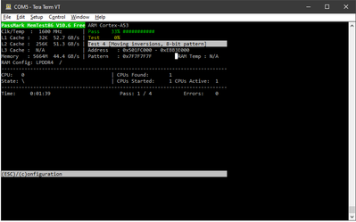

  2. I was able the MemTest86 to get running on the EVK. With help e.g. the 7-zip File Manager you can extract the content of memtest86-usb.img\0.MemTest86.fat\EFI\BOOT\ folder into EFI\BOOT\ folder on your SD card. It will then boot Memtest86 instead of our EFI.

My CPU part number is MIMX8ML8CVNKZAB.

Can you please try to run Memtest86+ on your board with your firmware if it shows any error? You only need to copy EFI folder from Memtest86+ image to your installation SD card and boot from it.  7-Zip File Manager can open Memtest86+ image file for example.
