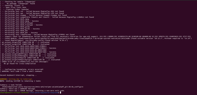

    I couldn'd found the old topic with the same name. So I setup this again.
    I tried to build sdk for imx8mm-evk, using command `bitbake -c populate_sdk imx-image-full`. But there is an error about qtpdf as follow picture
    Hope could get someone help again here.

Looks like you might be either missing some QT packages or having some versioning conflicts.
If the goal is to just generate the SDK. Try building a smaller option without all the QT and machine learning. It'll build much quicker as well.
bitbake core-image-minimal -c populate_sdk
Also is this a fresh yocto setup? Are you using a shared state cache?

It's a fresh yocto setup.
OTOH, there is a folder named "sstate-cache", did you mean that? The configuration is in default.
BTW, this issue was been repeated by another NXP employee and solved by adding some command in `local.conf` and `bblayers.conf` few days ago. But I forgot to markdown the modification and now I can not find that topic any more.

The sstate-cache is just a spot for yocto to consolidate packages that it checks before looking at mirrors. One way to speed up yocto builds with different configurations is to use a locally defined sstated-cache, but sometimes when doing so across several builds you can end up with multiple package versions that cause a similar problem. Fortunately, that is not the issue here.
Did Harley's link solve your issue?
