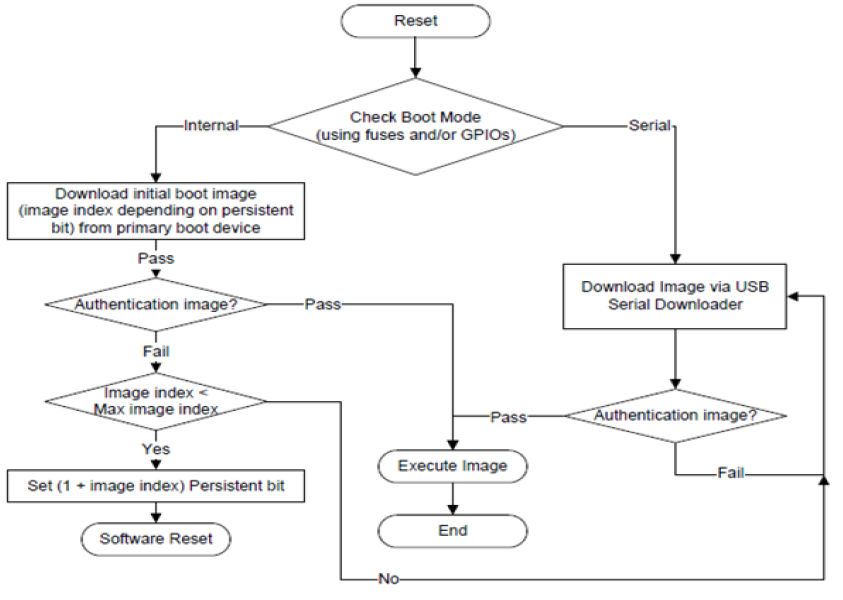

Will you please give me the short notes for booting sequence of IMX8QM-MEK with Arm Cortex-M4.
Some times resources (Display and Camera)  are occupied by Arm Cortex-M4

The booting sequence in high level is like below:
But you can see the complete sequence and the different mode that you can select on the reference manual of the IMX8QM, link below:
https://www.nxp.com/webapp/Download?colCode=IMX8MDQLQRM
Hope this help you.
