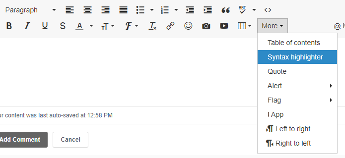

gh78731
@Victor Jimenez
Thanks for your comment. I have a discussion going over on iMX RT1020 about not being able to access the syntax highlighter from Google Chrome.  If I switch to Microsoft Edge, I can see the 'three dots' and access the Syntax Highlighter.
But, if I use Google Chrome, what I get for the toolbar is
No three dots, no access to Syntax Highlighter.
I can switch to MicroSoft Edge for reporting problems involving code snippets, but I prefer not to have to do that.

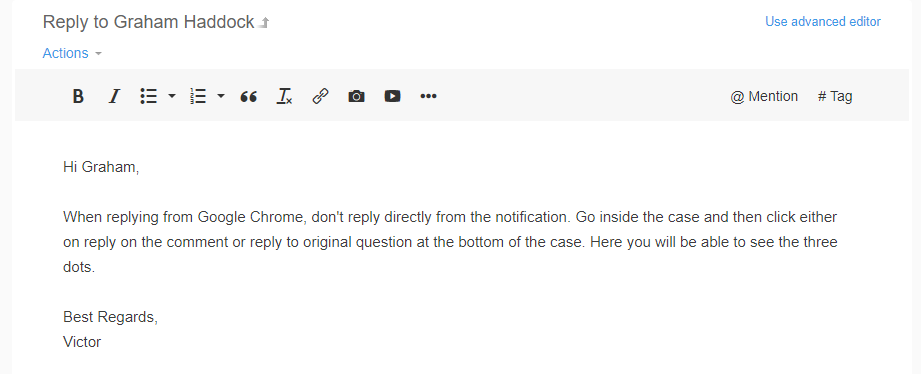

victorjimenez
Hi Graham,
When replying from Google Chrome, don't reply directly from the notification. Go inside the case and then click either on reply on the comment or reply to original question at the bottom of the case. Here you will be able to see the three dots. I'm using google chrome right now.
Victor
