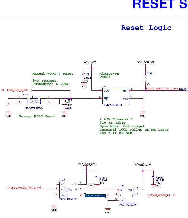

igorpadykov
only one reliable way to prevent boot hang is reset all board power
(shortly remove all voltages through pmic).
igor

igorpadykov
>What do you mean when you say remove all voltages through pmic ?
use solution from i.MX8QXP MEK schematic
>Secondly How to achieve that via software
this is not possible.
