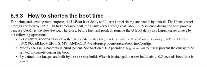

Hi All,
To shorten boot time we want to move to "user build variant"
I found that fastboot is going to recovery for user build variant
