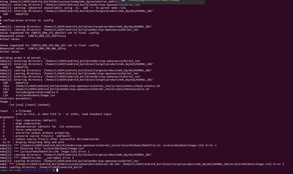

Has anyone else encountered this problem while trying to build Android 11 Automotive on Ubuntu for the iMX8 board?
It occurs when I run "./imx-make.sh -j4 2>&1 | tee build-log.txt" and prevents the kernel from being built.
Android 10 builds just fine.
Thanks.

So I was able to get around this issue. I was using the IMX8QM board, I was trying to run NXP's 11.0.0_2.4.0_ANDROID_SOURCE with an automotive build configuration. I guess automotive is not supported in this release. I ended up using NXP's automotive_11.0.0_2.3 instead and it built just fine. Thank you.
