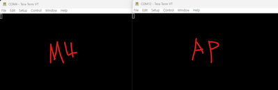

Dear NXP,
I'm using imx8dxl with cortex-M4F.
When I test sc_pm_set_resource_power_mode() to power off of A35, A35 is always Power On mode.
    sc_pm_set_resource_power_mode(ipc, SC_R_A35_0, SC_PM_PW_MODE_STBY);
    sc_pm_get_resource_power_mode(ipc, SC_R_A35_0, &get_mode);
    PRINTF("SC_R_A35_0 Mode = %d\r\n", get_mode);
result : SC_R_A35_0 Mode = 3
    sc_pm_set_resource_power_mode(ipc, SC_R_A35_0, SC_PM_PW_MODE_OFF);
I'm using below procedure.
1.boards/evkmimx8dxl/demo_apps/power_mode_switch/armgcc/build_ddr_debug.sh.
2. copy bin file to mk_image
3. make SOC=iMX8DXL REV=B0 flash_regression_linux_m4_ddr
4. download flash.bin
I want to power off A35 until check power resource on M4. when power resource is stable to boot A35, I want to power on A35.
Thank you.

pigbrian
Dear Aldo,
Thank you for reply.
Firstly, I made a hello_world without flag. It's working well.
./../mkimage_imx8 -soc DXL -rev A0 -append mx8dxlb0-ahab-container.img -c -flags 0x00200000 -scfw scfw_tcm.bin -ap u-boot-atf.bin a35 0x80000000 -p3 -m4 m4_image.bin 0 0x88000000 -dummy 0x87fc0000 -out flash.bin
Secondly, I made with flags. but I think it's halt. it's not displayed "hello world" on M4.
./../mkimage_imx8 -soc DXL -rev A0 -append mx8dxlb0-ahab-container.img -c -flags 0x00200000 -flags SC_BD_FLAGS_NO_AP -scfw scfw_tcm.bin -ap u-boot-atf.bin a35 0x80000000 -p3 -m4 m4_image.bin 0 0x88000000 -dummy 0x87fc0000 -out flash.bin
Could you comment for me.
PS : When I used power_mode_switch demo, I got same result.
Thank you.
