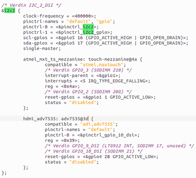

 rkathar_0-1753091144426.pngDevice Tree Changes
1. verdin-imx8mp_dsi-to-hdmi_overlay.dts
  • Removed the existing hdmi_lontium_lt8912 node.
  • Added a new hdmi_adv7535 node under the I2C2 node.

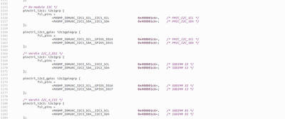

2. imx8mp-verdin.dtsi
  • Removed the hdmi_lontium_lt8912 node.
  • Removed Lontium pin connection details from the hdmi_connector node.
  • Added hdmi_adv7535 as a child node under I2C2.

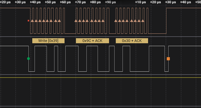

rkathar_1-1753091144431.png Observed Results After Changes
  1. Successfully able to read/write internal registers of ADV7535.
    1. Able to dump I2C data:
      torizon@verdin-imx8mp-15404184:~$ i2cdump -y -f 1 0x39
