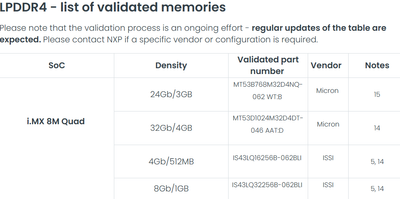

You can use it, and you can see the validation the DDR on the i.MX8MQ:
I found the link, it will do help for you:
i.MX 8M Quad/Mini/Nano/Plus - LPDDR4, DDR4 & DDR3L memory compatibility guide - NXP Community
