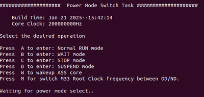

These are the commands which i am giving for Power Mode Switch Demo
fatload mmc 0:1 0x80000000 imx93_m33_TCM_power_mode_switch.bin
setenv mmcargs 'setenv bootargs console=${console} root=${mmcroot} clk_ignore_unused'
cp.b 0x80000000 0x201e0000 0x20000
saveenv
run prepare_mcore
bootaux 0x1ffe0000 0
boot
in the m33 core terminal the below print is observed
once after the booting if i press W in the m33 terminal the A55 core is not waking up.

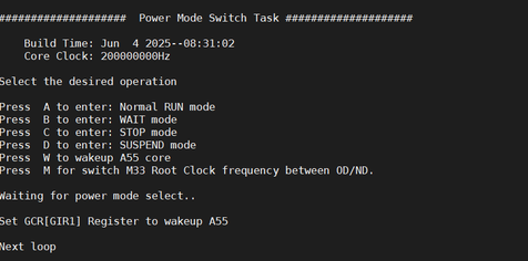

joanxie
I tested bsp 6.12.20 without having this issue totally, the steps are
 => load mmc 1:1 0x80000000 imx93_m33_TCM_power_mode_switch.bin
    => cp.b 0x80000000 0x201e0000 0x20000
    => bootaux 0x1ffe0000 0
=> run prepare_mcore
    => setenv mmcargs 'setenv bootargs ${jh_clk} ${mcore_clk} console=${console} root=${mmcroot}'
then after booting, use command  "echo mem > /sys/power/state", then use W in the m33 core, the A core can be waked up, you can findSet GCR[GIR1] Register to wakeup A55, then A core can wake up
