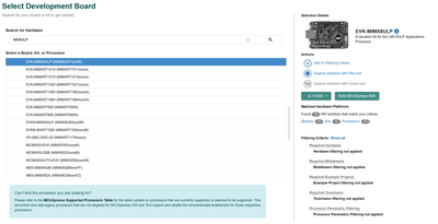

abdrhmn
Hi, @Chavira
The documentation that you provided is for iMX mini (if not mistaken). I also working on M33 8ULP platform. I checked from the MCUXpresso it seem 8ULP board is not available. Is there any equivalent board available in the MCU can be used for debugging? I worked on Lpuart edma, it is hard to debug without using JTAG.

Chavira
Hi @abdrhmn!
The SDK for iMX8ULP is avaiable on our webpage!
Best Regards!
